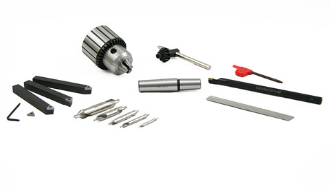

Tooling Package, Deluxe Mini Lathe Premium
- 1/2" professional grade drill chuck
- 2MT standard to 33JT drill chuck arbor
- 3/8"- 6" long indexable boring bar - CCMT inserts
- 3/8" indexable TCMT carbine inserts
- Premium P1 cut-off blade, 5 center drills
Weight: 3.17 lb
Purchased individually $193.74
The package does not include a quick change tool post because there is one on the model 4200/5200/7350 deluxe lathe.
Drill Chuck: The 1/2" capacity professional grade drill chuck is mounted on a short 2MT shank for the mini lathe. Specifically designed for the mini lathe tailstock, the rated capacity is 1 mm (0.039") to 13 mm (0.512"). All working parts are hardened. Chuck key included. Number 33 Jacobs taper mount. This chuck is comparable to a Jacobs 34-33 heavy duty drill chuck, including the runout specification of 0.004" (0.10 mm) or less.
Indexable Inserts: Indexable turning tools are made by AR Warner Co in the USA. These Warner precision tool holder kits use carbide inserts and include three styles of tools, AR right hand, E Neutral (threading tool - 60 degree angle), and AL left hand. Kit includes three tool holders, TCMT inserts, one extra TCMT-21.52 carbide insert, one extra Torx screw, and one wrench.
Boring Bar: This 3/8" diameter indexable boring bar uses CCMT inserts and is 6" long. The minimum bore diameter for this is 0.50". The boring bar takes CCMT 21.51 or CCMT 21.52 inserts.
Cut-Off Blade: The premium P1 parting blade is 1/16" x 1/2" x 4-1/2" and made from M2 HSS by Arthur R. Warner Co. in the USA. These T-shape parting blades provide great side clearance.
Center Drills: Five sizes combined drills and countersinks made of high speed steel. Sizes 1, 2, 3, 4, and 5 with 60 degree counter sinks.
The 2 Morse taper is the correct length for the lathes listed below. Don't buy this product for other lathes as it won't eject from the tailstock when you retract the quill.
Size P1 blades are 1/16" wide and are the most commonly-used size. P1N blades are 0.040" wide. These thinner blades are good for small work. P1X blades are 5/64" wide. Use these thicker blades for parting off larger diameters where you need additional stiffness.
It is easier to part off large diameters if you cut a groove that is wider than the cut-off blade. First, make a cut about 0.100" deep. Now back out and move over at least 0.010". Cut in again, widening the slot. Continue with this cut until you are 0.100" deeper than the first slot. Repeat this process, moving back and forth, until you are through.
