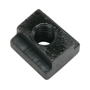

T-Slot Nut (8 mm)
T-Slot Nut (8 mm)
These T-slot nuts fit a 8 mm T-slot, and are threaded M6.
These T-slot nuts work with the micro mill and some rotary tables.
They are heat treated and have a black oxide finish.
Part Number: 2058
Weight: 0.02 pounds
Price: $1.95
Part Number
Slot
B
Thread A
C
D
E
Length
1268, 2021
1/2"
0.49"
3/8" - 16
0.50"
0.28"
0.88"
0.88"
1269, 1144
7/16"
0.43"
3/8" - 16
0.50"
0.28"
0.69"
0.88"
1418
12 mm
11.7 mm
M8
12 mm
7 mm
18 mm
18 mm
2991
10 mm
9.7 mm
M8
12 mm
6 mm
15 mm
15 mm
1813, 1972, 2039, 2058, 2175
8 mm
7.7 mm
M6
10 mm
5 mm
13 mm
13 mm
1943, 2059
6 mm
5.7 mm
M5
8.2 mm
4 mm
10 mm
12 mm
This product works with mills with a 0.31 to 0.38 inch T-slot width including:
