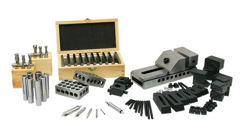

Tooling Package, 2MT Micro Mill
- 3" toolmakers screwless vise and 11 pairs of 3" long thin parallels
- Precision 1-2-3 Blocks and 36-piece Clamping Kit - 8 mm T-slot
- Two 6-piece end mill sets, 2 and 4 flute and 5 center drills
- Seven piece 2MT collet set
- Combination edge and center finder
Weight: 21.5 lb
Purchased individually $439.40
Toolmakers Vise: 3" toolmakers screwless vice has a one-piece body. The body and jaws are hardened to Rc 58-62. All sides are flat, square and parallel to 0.0002". There are horizontal and vertical vees on the inside face of the movable jaw to hold round objects. The vise jaws are 1.38" deep and open to 3.78" capacity. The vise is 7.28" long, 2.76" tall and 2.785" wide.
Thin Parallels: Set of 11 pairs, 1/8" thick x 3" long. Made of high-grade alloy steel hardened to 52-58 Rc, parallel within 0.0002" on top and bottom.
Parallel heights: 1/2", 9/16", 5/8", 11/16", 3/4", 13/16", 7/8", 15/16", 1" with two pairs of shims are 9/64" and 5/32" (pairs matched within 0.0004").
Clamping Kit: 36-piece kit fits 8 mm T-slots on a micro mill. Includes 10 M6 studs, 4 step block pairs, 6 T-slot nuts, 6 flange nuts, and 6 step clamps.
End Mills: 6-piece 4 flute and 6-piece 2 flute, HSS, center cutting end mill sets. Sizes 1/8", 3/16", 1/4", 5/16", 3/8", and 1/2". All with 3/8" shanks.
2MT Collets: Set of seven high-grade tool hardened steel round collets, sizes 1/8", 3/16", 1/4", 5/16", 3/8", 7/16", and 1/2". The drawbar thread is 3/8"-16. This set includes all the sizes required for common end mills.
1-2-3 Blocks: Ground and hardened on all sides to 50-60 Rc, sizes 1" x 2" x 3". Parallel within 0.0002", flat within 0.0002", and square within 0.00021". Set has two matched blocks, 23 holes of which 5 are threaded 3/8"-16 NC.
Center Drills: Five sizes combined drills and countersinks made of high speed steel. Sizes 1, 2, 3, 4, and 5 with 60 degree counter sinks.
