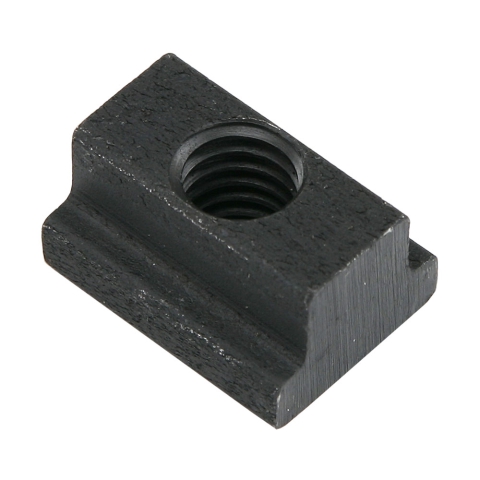

T-Slot Nut, 7/16"
- Fits 7/16" (12 mm) T-slots
- Threaded 3/8"-16
- Black oxide finish
- Heat treated 1040 steel, case hardened
- Fits T-slots measuring 0.43" to 0.49" in width
These T-slot nuts fit a (12 mm) 7/16" T-slot and are threaded 3/8"-16.
The nuts are the correct size for the Mini Mill.
The nuts are heat treated and have a black oxide finish.
The stated dimension of the T-slot nut is the width at the top of the T-slot.
Measure the width at the top of the T-slot as shown in the photo below. This is the dimension given for T-slot nuts and clamping kits. For example, if you measure 0.468 at the top of the T-slot, you should get a 7/16” (0.438”) T-slot nut or clamping kit.
