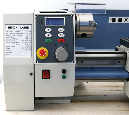

3536 Hitorque Bench Lathe Control Panel

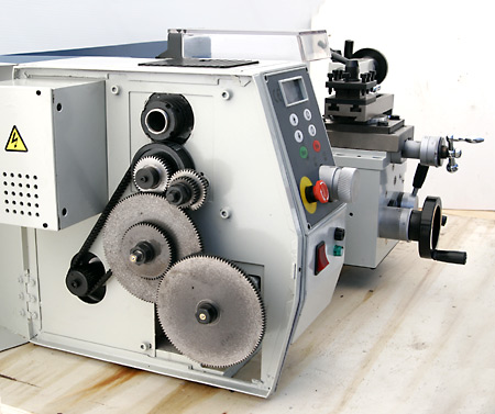

3536 Hitorque Bench Lathe Change Gears

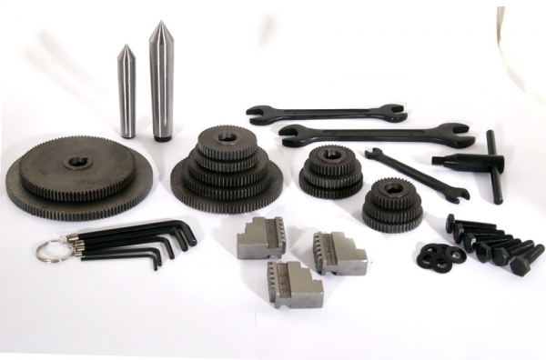

3536 Hitorque Bench Lathe Included Accessories
Contents
The Bench Lathe comes with the following:
  • 4" (100 mm) 3-jaw self centering lathe chuck with two sets of jaws and a chuck wrench
  • A #3 Morse taper dead center for the headstock
  • A #2 Morse taper dead center for the tailstock
  • Change gear set
  • Three open end wrenches
  • Five hex (Allen) wrenches
