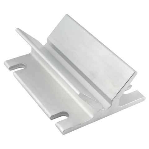

Center It V-Block
- CENTER IT makes it easy to drill round stock and tubing
- Bolts to the drill press table and enables the drilling of round pieces parallel and centered
- Grooves on the outer sides eliminate slippage while holding by hand for sawing
- Place CENTER IT on the drill press table, run the stationary bit down to center the fixture
CENTER IT is a tool for drilling pipe and other round objects. The CENTER IT v-block is made specifically for use in a drill press. No clamping of the tube is necessary since the angled flats of the jig hold it centered. Holes will automatically be centered on the tube with no center-punching required. If tubing is too large to drill in a single operation this drill press v-block can simply be turned over.
An essential aid for machinists, woodworkers, mechanics, and other shops. CENTER It v-block makes speedy and precise work of drilling tasks. Its "hand vise" grip ridges allow no-clamp holding of round stock for sawing and cutting.
Made of heavy aluminum extrusion, the CENTER IT v-block has four bolt down slots should you want to mount it to a table or heavy plate.
The CENTER IT drill press v-block is 5" Long, 4" Wide, and 1-3/4" High. The groove at the base of the V is 7/16" wide and has a 188 degree angle so you can bottom your drill to center.
Length | 5.00" (127.0 mm) |
Width | 4.00" (101.6 mm) |
Height | 1.75" (44.4 mm) |
Bolt Down Slots Width | 0.39" (10.0 mm) |
Bolt Down Slots Length | 0.67" (17.0 mm) |
Bottom Groove Width | 0.4375" (11.112 mm) |
Bottom Groove Angle At Bottom | 118° |
End View |
Side view, grip surface visible |
In use on drill press |
