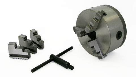

  • 3-jaw lathe chuck
  • 6" (160 mm) diameter
  • Includes chuck key, inside and outside jaws
  • Specific flange backplate for mounting on C8 lathe
Part Number: 5049
Weight: 23.6 lb
Price: $189.99
PayPal Credit
This 6" 3-jaw lathe chuck comes with a chuck key and reversible inside and outside jaws. It can hold work up to 5.71" (145 mm) in diameter.
Rated Capacity, Inside Jaws 0.12" - 2.17" (3.0 mm - 55.0 mm)
Rated Capacity, Jamming Range 1.97" - 6.30" (50.0 mm - 160.0 mm)
Rated Capacity, Outside Jaws 2.17" - 5.71" (55.0 mm - 145.0 mm)
Runout (Max) ≤ 0.0032" (0.081 mm)
Diameter, Overall 6.30" (160.0 mm)
Registration Recess Diameter 5.12" (130.0 mm)
Registration Recess Depth 0.20" (5.0 mm)
Bolt Circle Diameter 5.59" (142.0 mm)
Center Hole Diameter 1.57" (40.0 mm)
Height 2.56" (65.0 mm)
Jaw Height Above Face 1.18" (30.0 mm)
Height with Jaws 3.74" (95.0 mm)
Number and Size of Bolts 3 M8
Chuck Key 0.374" (9.50 mm)
Max RPM 3600 RPM
