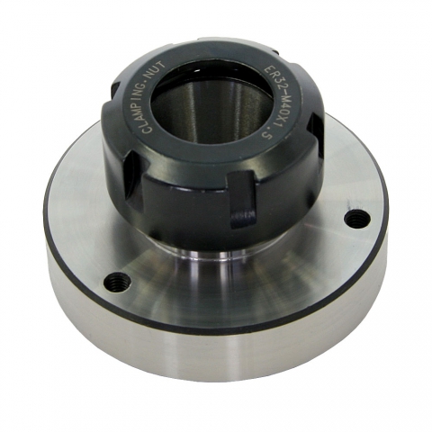

This 3” diameter ER-32 collet chuck mounts on the lathe spindle in place of the lathe chuck or can be used as a fixture on a milling table.
ER collet chucks range in size from 3/32" up to 13/16" so you can run 25/32" (the through hole on the lathe spindle is 0.800") stock through the headstock of your mini lathe.
The outside diameter of the lathe collet chuck is 80 mm. It has a 55 mm registration diameter and mounts with three M6 bolts on a 66 mm bolt circle. The concentricity of this chuck is 0.0002" (0.0051 mm).

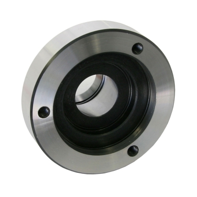

3 inch Diameter Collet Chuck for ER-32 Collets - Reverse Reverse View
