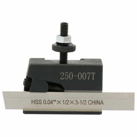

1 - #7 Universal Parting Blade (for 1/2" cut-off blade - horizontal)

The 3112 has a cut-off tool holder that mounts the blade horizontally. Thus it can be used on lathes that have only 5/8” from the top of the compound to the centerline of the lathe, like the 7x mini lathes.
The 3048 has a cut-off tool holder that mounts the blade at a 4 degree angle. It needs ¾” from the top of the compound to the centerline because of the angled cut off blade.

View of Cut-Off Tool Holder, 0XA, with half inch cut-off blade
"QC Cut-Off Tool Holder Universal Parting Blade Tool Holder showing pitch of cut-off blade.
