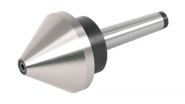

Live Center, 2MT Standard Bull Nose
  • For tubing and other hollow work
  • Point is a 70º included angle
  • Standard bull nose 2 Morse taper
  • 5.31" total length
Part Number: 3154
Weight: 2.30 lb
Price: $99.95
This bull nose live center is made from hardened steel and ground for accuracy. It has precision high quality bearings. The nose is a 70º included angle.
The diameter of the nose is 2.45". The diameter of the flat on the front of the nose is 0.46".
