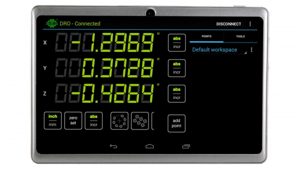

* 3-axis digital readout (DRO) with Bluetooth and 7" tablet display. The DRO is completely installed on the mill.

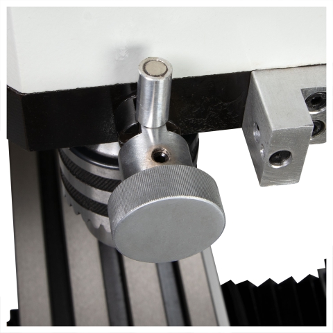

* Electrically interlocked spindle lock

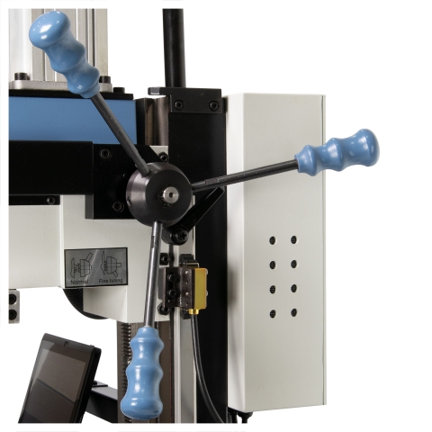

The HiTorque mini milling machine for sale has drill press handles for drilling and fast motion of the mill's head. It also has Z-axis fine feed with 0.001" resolution for milling operations.

Here's Using the Bluetooth DRO Display.
For more information on the Bluetooth DRO, visit the Bluetooth DRO Package page and the Android Tablet page.

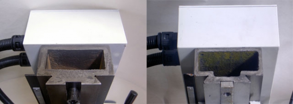

The solid column is much more rigid than the tilting column.
Some people may feel that the tilting column is a feature, but I have used a mini mill for 10 years and never tilted the column on purpose.
Let's compare the LittleMachineShop.com Solid Column HiTorque Mini Mill to mini mills with a tilting column.
The tilting column on other folk's mini mills tilts 45 degrees from side to side. This has several advantages. First, it is possible to make some angled cuts. It's also easy to tram in the X-axis. One user (and only one) has described to me a cut that was impossible to make any way but using a tilting column.
This mill has a solid column. While it is harder to tram in the X-axis because you must use shims, it is not as easy to knock it out of tram as the tilting column mini mill. The solid column has thicker walls than the tilting column, and a stiffer joint where it joins the base, so the column is significantly more rigid than the tilting column.

  • 3-Axis DRO with 7" Android tablet readout

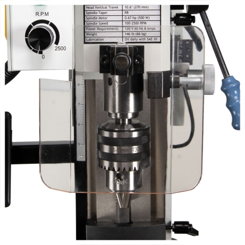

Spindle Taper R8
Spindle Motor 0.67 hp (500 Watts)
Spindle Speed 100 - 2500 RPM

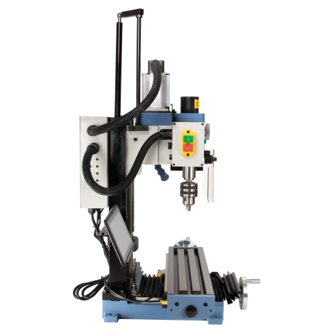

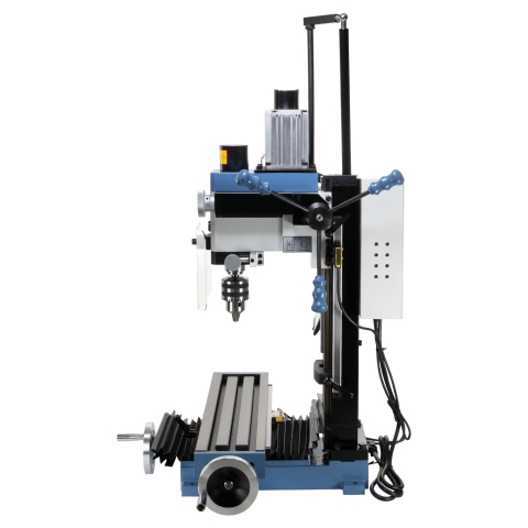

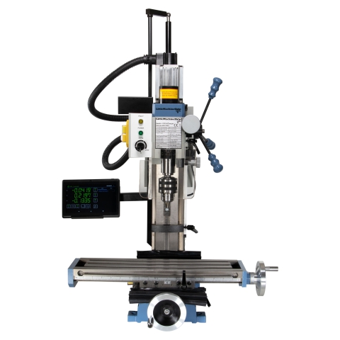

Deluxe HiTorque Solid Column Mini Mill Deluxe HiTorque Solid Column Mini Mill
Side View Deluxe HiTorque Solid Column Mini Mill Side View

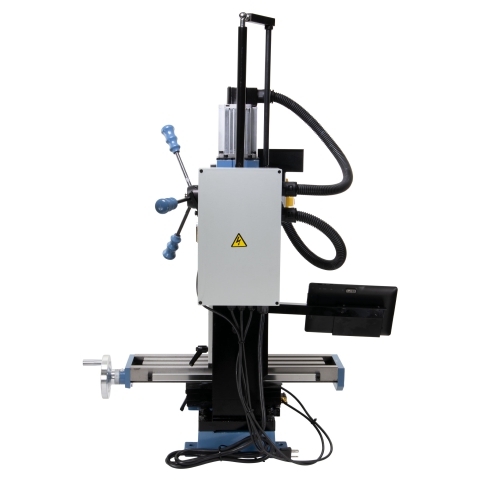

Rear View Deluxe HiTorque Solid Column Mini Mill Rear View

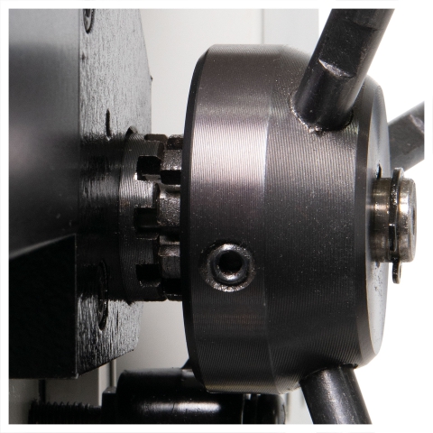

Anodized aluminum hand wheels - Deluxe HiTorque Solid Column Mini Mill Anodized aluminum hand wheels

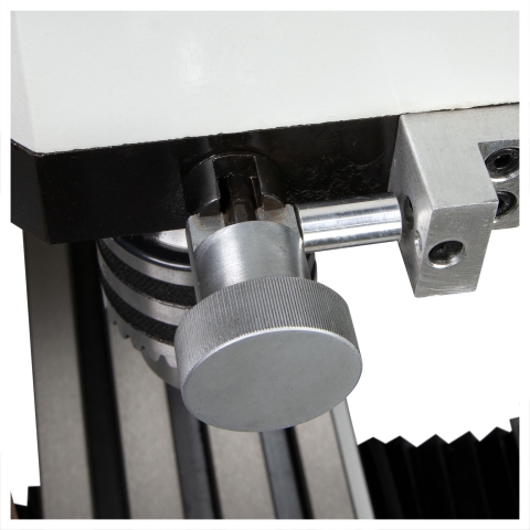

Electronically Interlocked Spindle Lock - Deluxe HiTorque Solid Column Mini Mill Electronically Interlocked Spindle Lock

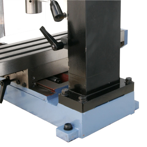

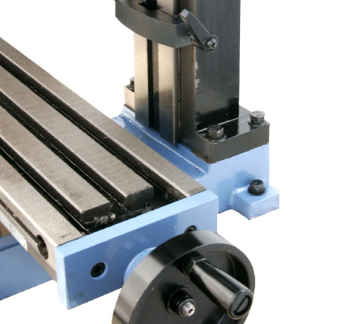

Solid Column Base Solid Column Rigid Base
Solid Column Base from Back Back View Solid Column Rigid Base
"The solid column on the left The solid column on the left, tilting column on the right. The solid column has significantly thicker walls
