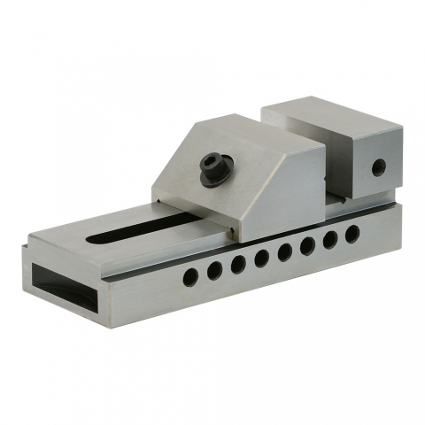

- high precision toolmakers screwless vise
- Square and Parallel within 0.0002"
- Ground "V" Way
- Hardened and Precision Ground

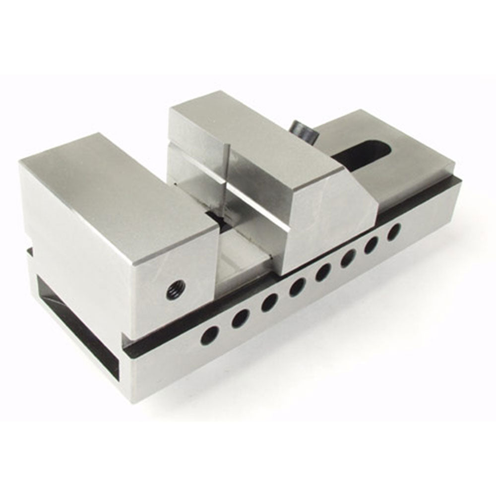

This high precision toolmakers screwless vise has a one-piece body. There are horizontal and vertical vees on the inside face of the movable jaw to hold round objects.
The jaws are 1.38" deep and open to 3.78" capacity.
The vise is 7.28" long, 2.76" tall and 2.875" wide.
All sides are flat, square and parallel to 0.0002".
The body and jaws are hardened to Rc 58-62.
You can use your clamping kit to secure this vise using the slots in the ends, but we recommend that you make a couple of clamping blocks to secure the vise across the table. You can also purchase pre-made clamps here: Screwless Vise Clamps.
Take a look at our vise comparison page before you choose a vise.
Jaw Depth: 1.38" (35.052 mm)
Maximum Jaw Opening: 3.78" (96.012 mm)
Weight: 9.9 lbs (4 kg)
Height with Out Base: 2.76" (70.104 mm)
Length: 7.28" (184.912 mm)
Width with Out Base: 2.875" (73.025 mm)
