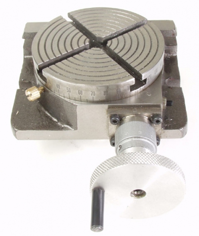

This 4" diameter rotary table has an overall height of less than 2". The table can be locked in any position. The center height in the vertical position is 2 1/16". The hand wheel scale, which can be zeroed, is marked in degrees and 10 min divisions. The table is calibrated in 5 deg increments around the rim. The bronze worm wheel and steel worm with 36 to 1 ratio are adjustable to take up wear.
The T-slots in this rotary table are pretty small. We offer a set of T-slot nuts and clamping bars that are just the right size.
