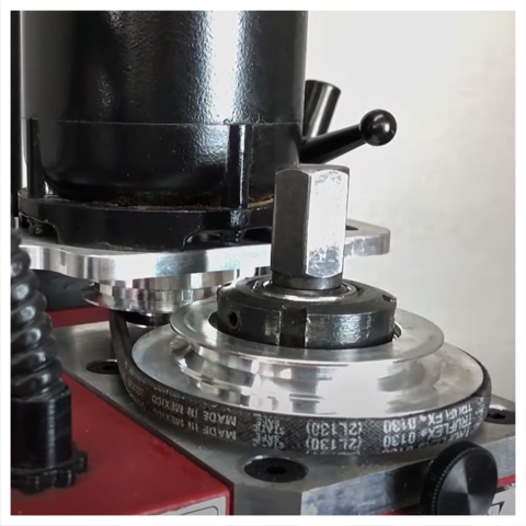

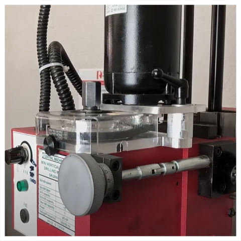

This kit is CNC-machined from the highest quality materials. Designed to run full-time, it is built to last. The belt drive conversion kit includes one belt.
Change speeds without any tools. Simply remove the guard, loosen the lever locks and move the belt from one pair of pulleys to the other. Low speed range is 0-1700 RPM. High speed range is 0-4300 RPM.
The installation is bolt-on and takes about 20 minutes.
This belt drive kit fits the mills shown on the Compatibility tab. Don't expect it to fit other machines.
The small pulley has a 9 mm bore with a 3 mm keyway. The large pulley has a 30 mm bore with a 5 mm keyway. If your shafts don't match these values, then this belt drive will not fit your mill.
Installed |
Installed - cover removed |
