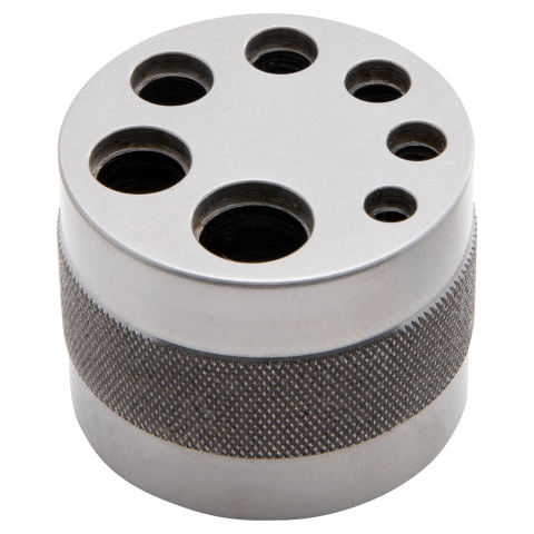

- Starts taps straight - reduces breakage
- Fits taps from 0-80 to 3/8-16
- Elegant design
Weight: 0.45 lb
Price: $44.95
The OMW Tapping Block was inspired by a block used nearly every day by a master tool and die maker I had the pleasure of working with in my shop. He used his block whenever tapping a hole, and I never saw him break a tap! Simply hold the tapping block flat against your work, above the hole you've tap drilled. Place your tap through the appropriately sized guide hole and you are assured of perfect tap alignment when starting your thread.
The OMW Tapping Block is manufactured of the highest quality 4140 steel. It is beautifully designed, expertly knurled and chamfered for easy grip, with counterbored holes to allow for material chip clearance when tapping. Fits all common taps from 0-80 thread to 3/8-16 (the seven holes fit tap shanks of #0-#6, #8, #10, #12, 1/4, 5/16, and 3/8). This Tapping Block should be in the tool chest of every machinist, from beginner to expert.
