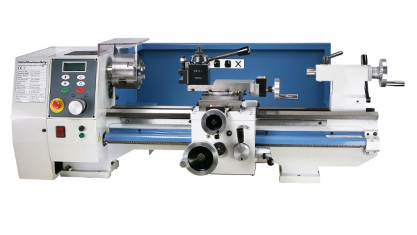

HiTorque 8.5x20 Deluxe Bench Lathe 3595  (Discontinued)
  • Digital dials, inch and metric threading
  • 120VAC 60 Hz
  • 1000 Watt (1.34 HP) brushless DC drive
  • Power longitudinal feed and power cross feed
  • 4" (100 mm) 3-jaw self centering lathe chuck
Part Number: 3595  (Discontinued)
Weight: 281 lb
Price: $2,349.95
DISCONTINUED - This HiTorque Mini Lathe has been replaced by the 7550 HiTorque 8.5x20 Deluxe Bench Lathe. All the great features of 3595, plus magnetic scales on the carriage and cross slide that communicate via Bluetooth to a DRO tablet display; a tailstock DRO; and a new, improved control panel.
View a comparison of the specifications for our lathes.
These machines have genuine NSK bearings. Getting genuine bearings in China is not easy as there are so many fakes around. We had SIEG contact the NSK factory to see where to purchase genuine NSK bearings that they could count on as not being fakes.
The HiTorque 8.5x20 Bench Lathes offer extended threading capabilities. Here's a document that explains how to set the change gears on the HiTorque Bench Lathes.
Here are data sheets for the machines that we sell.
Here are the users guides for the machines we sell.
  • 1000 Watt output spindle motor
  • DRO on compound and cross feed
  • AXA quick change tool post set
  • Genuine NSK ball bearings
  • Induction hardened ways
  • Anodized aluminum hand wheels, knobs, and levers with black anodizing in hand wheels
  • Power cross feed
  • E-stop safety power switch
  • Extended threading capability - inch and metric threads
  • Cam lock tailstock
  • Zero-resettable dials graduated in inches and mm
  • Reversible lead screw for right and left hand threads
Swing Over Bed 8.5" (215 mm)
Swing Over Saddle 4.6" (118 mm)
Distance Between Centers 20" (510 mm)
Spindle Through Hole 0.8" (20 mm)
Spindle Motor Output 1.34 hp (1000 Watts)
Range of Threads 8-80 TPI (0.2-8.0 mm)
Spindle Taper #3 Morse taper
Tailstock Taper #2 Morse taper
Spindle Speed 100 - 2000 RPM
Cross Slide Travel 3.9" (100 mm)
Power Requirements 120 V 60 Hz 12 Amps
Crated Weight 281 lbs (128 kg)
Machine Weight 220 lbs (100 kg)
Overall Dimensions (W x D x H) 40" x 22" x 16" (1010 mm x 550 mm x 400 mm)
Crate Dimensions (W x D x H) 44" x 28" x 22" (1110 mm x 700 mm x 550 mm)
"HiTorque 8.5x20 Bench Lathe Deluxe HiTorque 8.5x20 Bench Lathe
"Splash Guard - HiTorque 8.5x20 Bench Lathe Improved splash guard on the Deluxe HiTorque 8.5x20 Bench Lathe
"AXA QCTP and DRO - HiTorque 8.5x20 Bench Lathe AXA Quick Change tool post, DRO and modified compound rest on Deluxe HiTorque 8.5x20 Bench Lathe
"Anodized aluminum hand wheels - HiTorque 8.5x20 Bench Lathe Anodized aluminum hand wheels, knobs and levers on Deluxe HiTorque 8.5x20 Bench Lathe
The Deluxe Bench Lathe comes with the following:
  • 4" (100 mm) 3-jaw self centering lathe chuck with two sets of jaws and a chuck wrench
  • AXA Quick change tool post set
  • A #3 Morse taper dead center for the headstock
  • A #2 Morse taper dead center for the tailstock
  • Change gear set
  • Three open end wrenches
  • Five hex (Allen) wrenches
  • Android tablet for the DRO
