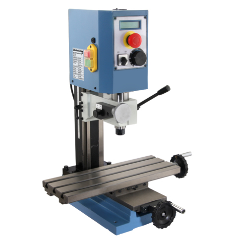

The LittleMachineShop.com HiTorque Micro Milling Machine is the best in its class. It has the most power, most torque, and a larger table than other mills in its class.
The 250 Watt brushless spindle drive motor provides tremendous low-end torque. And you can vary the speed from 100 rpm to 5000 rpm continuously. There are no gears or belts to shift. And, with no gears, the HiTorque Micro Mill is the quietest in its class.
The large mill table provides 50% more width than other micro mills. The resettable feed dials allow you to zero them at any point.
The HiTorque Micro Mill has a drill press handle for drilling. It also has Z-axis fine feed with 0.001" resolution for milling operations.
This is a version of the SIEG SX1P Micro Mill.
You can compare the specifications for our mills.
Here are data sheets for the machines that we sell.
These machines are fully assembled, adjusted, and tested at the factory. Then the column and head is removed from the base so they can ship in two components. This reduces the shipping cost by about half.
When you get the machine, use the four bolts provided to fasten the column to the base and you are ready to go. The manual has complete instructions.
  • 250 Watt output spindle motor
  • Large X-Y table
  • ER-16 Spindle for small cutting tools
  • Solid column that does not tilt
  • Dovetail column maintains head alignment at any height
  • Fine feed on Z-axis for precise control
  • Radial handle for drilling
  • E-stop safety power switch
  • Adjustable Z-axis stop for repetitive drilling
  • Adjustable gibs on all dovetail ways
  • Includes 3/8" capacity drill chuck and arbor
End Milling Capacity 0.4" (10 mm)
Face Milling Capacity 0.6" (16 mm)
Drilling Capacity 0.4" (10 mm)
Table Size 15.7" x 5.7" (400 mm x 145 mm)
T-slots 3 slots 0.31" (8.0 mm) wide
X-Axis Travel 11.8" (300 mm)
Y-Axis Travel 5.9" (150 mm)
Z-Axis Travel 8.7" (220 mm)
Throat 5.5" (140 mm)
X- and Y-Axis Feed Screws 0.050" (1.27 mm) per rotation
Head Tilt None
Quill Travel 0.9" (22 mm)
Spindle Taper ER-16
Spindle Motor 0.34 hp (250 Watts)
Spindle Speed 100 - 5000 RPM
Power Requirements 120 V 60 Hz 5 Amps
Machine Weight 106 lbs (48 kg)
Base Dimensions (W x D) 8.5" x 14.0" (216 mm x 356 mm)
Mounting Holes Center to Center (W x D) 7.09" x 11.81" (180.0 mm x 300.0 mm)
Overall Dimensions (W x D x H) 20.5" x 19.3" x 28.7" (520 mm x 490 mm x 730 mm)
Crated Weight 117 lbs (53 kg)
