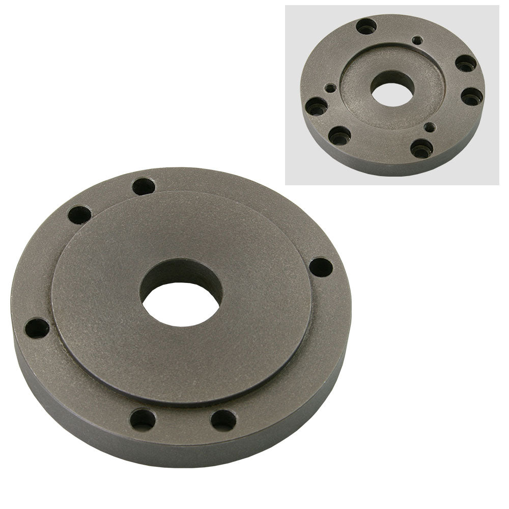

- Compatible with 5" 3- or 4-Jaw Lathe Chuck with 95 mm Registration Recess
- Can Use on a Flange for 4" Chuck with 72 mm Registration Boss
- Works on 8x12 and 8x14 Lathes
This adapter mounts a 5" 3- or 4-jaw lathe chuck with a 95 mm registration recess on a flange for a 4" chuck with a 72 mm registration boss. It works on 8x12 and 8x14 lathes as well as the Harbor Freight 5980 multipurpose machine. It also fits the SIEG C4 lathe.
Outside Diameter: Ø 4.921",125 mm
Center Hole: Ø 1.181", 30 mm
Spindle Side Registration Recess: Ø 2.835",72 mm
Spindle Side Bold Circle: Ø 3.307",84 mm
Chuck Side Registration Boss: Ø 3.740",95 mm
Chuck Side Bolt Circle: Ø 4.252",108 mm
Thickness: Ø 0.630",16 mm
Chuck Mounting Holes: 6
