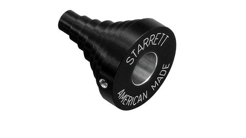

- Starrett Catalog Number PT28314
- Compatible with Any Attachment with a 3/8" Post
- Eliminates Need to Change Collet to Use Edge Finder

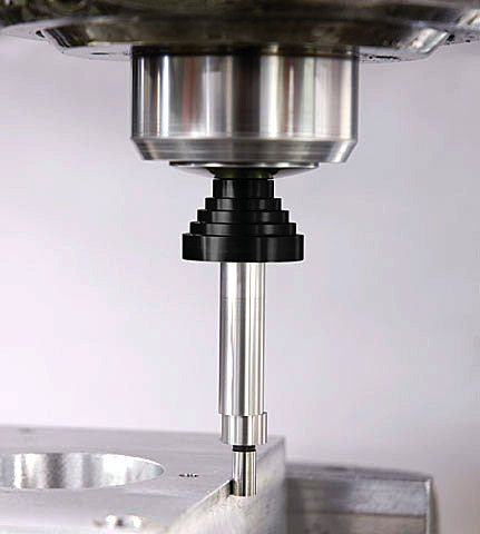

This is a time saving accessory for edge finders with a 3/8" shank.
The collet adapter allows quick installation and removal of the edge finder, eliminating the need for collet changes on Bridgeports and similar machines. It can be used with any attachment with a 3/8" shank.
The progressive steps are 1/4", 5/16", 3/8", 1/2", 5/8", 3/4" and 1". Step depths vary from .100" to .200".
Chris's Tips
This is a neat gadget. Don't change a collet just to use an edge finder. Simply stick this adapter in until you reach the step that fits the collet that is already in your spindle.
This adapter won't work with combination edge and center finders. The hole is not deep enough for the business end to go in.
