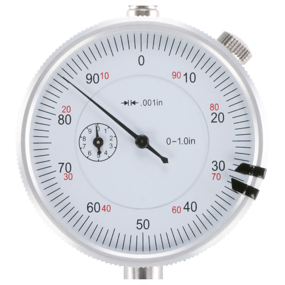

  • 0-1" dial indicator with 0.001" resolution

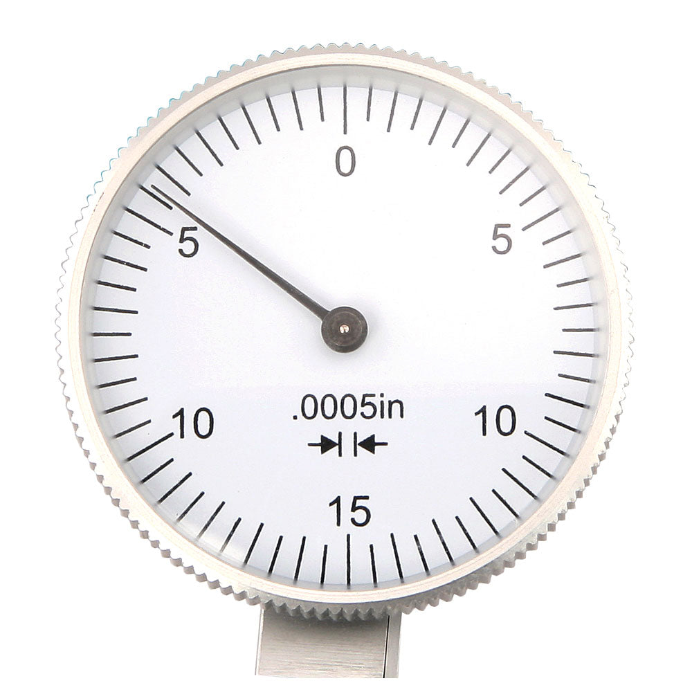

  • 0-15-0 dial test indicator with 0.0005" resolution

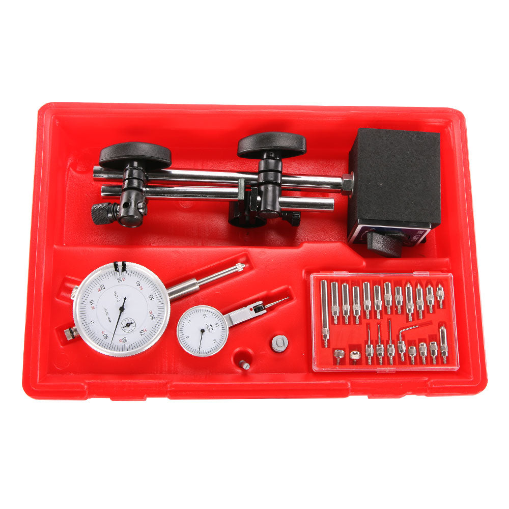

  • Magnetic base indicator holder with fine adjustment
  • 22 piece indicator point set
  • All in a plastic case

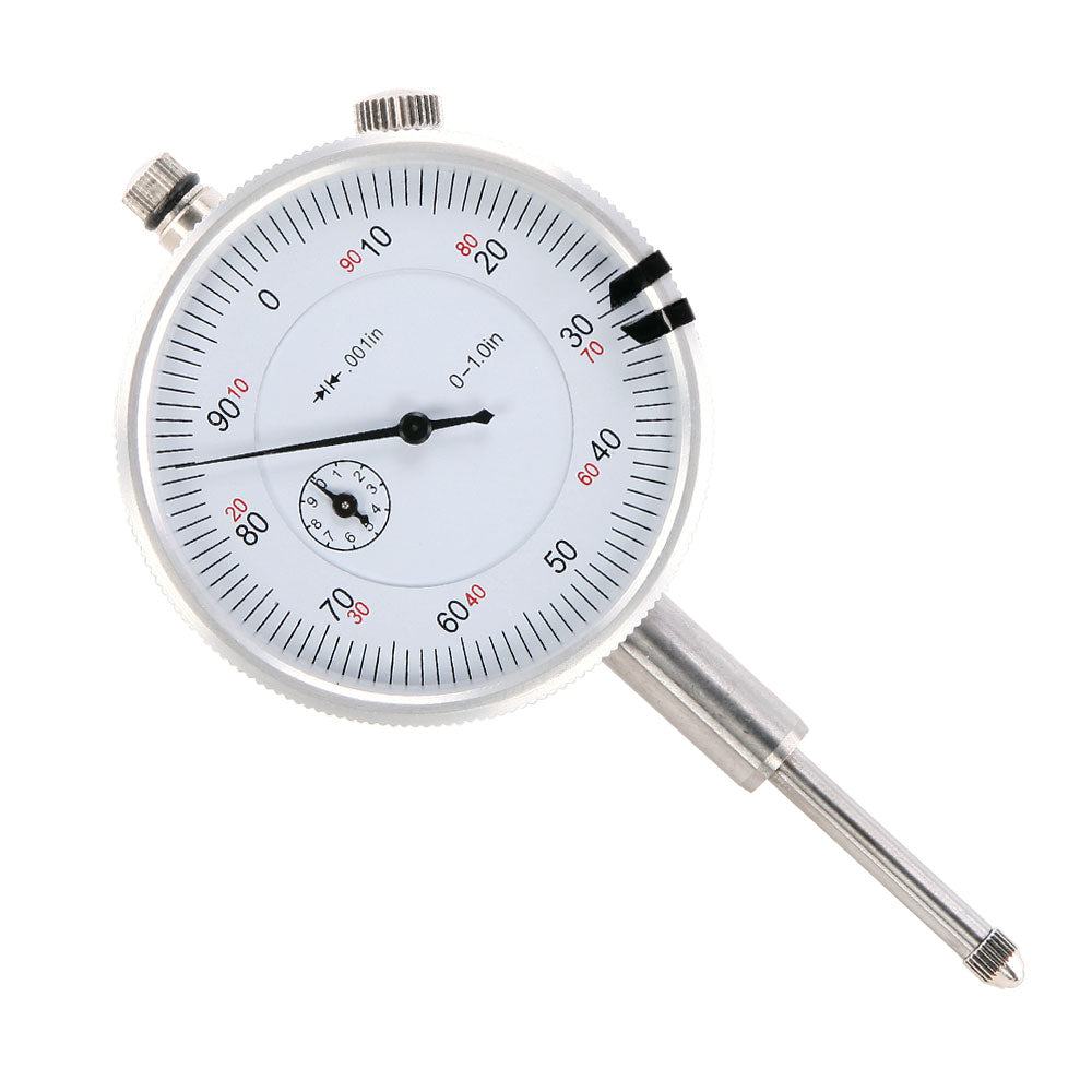

The 1" stroke dial indicator features large, easy to read numbers and crisp graduations. Each revolution is 0.100", indicated by the revolution counter. The resolution is 0.001". There is a mounting lug on the back of the case. This is an AGD Group 2 indicator with a 2.25" Diameter face, 0.375" shank, and #4-48 tip thread.
The dial test indicator has 0.0005" graduations and a 7 jewel movement. Its range is 0.030" in either direction. Includes 5/32" and 3/8" diameter posts, dovetails on the back and end, and an 0.080" diameter point.
The magnetic base indicator holder has a fine adjustment feature. The on/off switch makes it easy to position. The v-groove base allows you to mount it on cylindrical surfaces.
Includes a 22 piece indicator point set and a plastic case.

At rest, an indicator’s needle points at a random position, usually in the 10 o’clock range. This is completely normal, as the needle’s position at rest is irrelevant to the use of an indicator.
An indicator is only useful when the tip is bearing against a surface to be measured. The action of pressing the tip against the surface moves the needle, also to some random position. But this position is relevant; turn the bezel so that the needle is pointing at zero. Now you can make measurements, both positive and negative, relative to the starting position.
