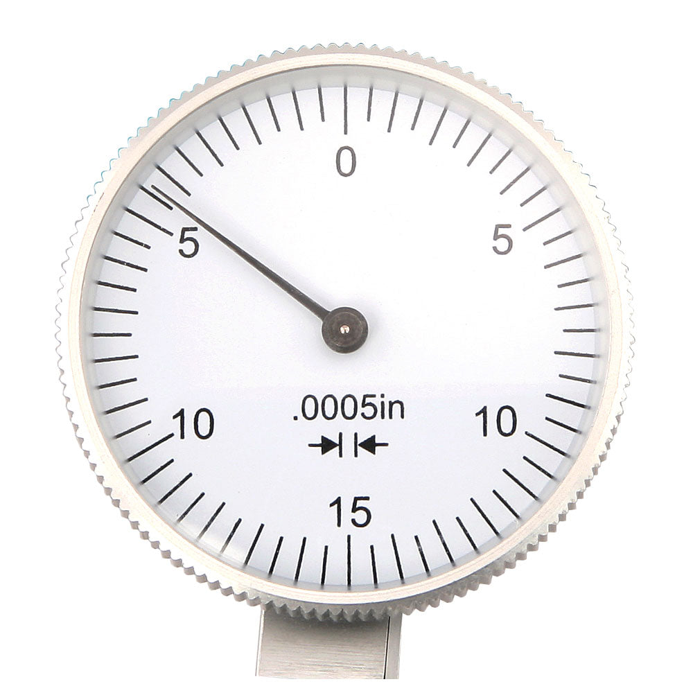

- 0-15-0 dial test indicator with 0.0005" resolution

The dial test indicator has 0.0005" graduations and a 7 jewel movement. Its range is 0.030" in either direction. Includes 5/32" and 3/8" diameter posts, dovetails on the back and end, and an 0.080" diameter point.
