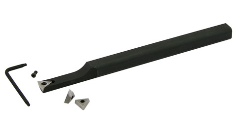

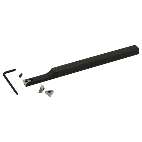

  • 1/2" diameter, 5" long HSS boring bar with TPMW-221 insert
  • 2 extra TPMW-221 high speed steel inserts
  • 1 extra Torx screw
  • 1 wrench
Part Number: 1721
Weight: 0.64 lb
Price: $139.95
PayPal Credit
This Arthur R. Warner Co. precision indexable boring bar uses high speed steel inserts. Combine the advantages of high speed steel cutting tools with the convenience of indexable tooling.

Our Indexable Turning Tool Set was first introduced in July of 1998. Since the introduction, we have expanded our sizes of Turning Tool Sets, introduced 2 sizes of Indexable Boring Bar Kits, a Profiling Kit and a Threading Kit with the appreciated input from numerous Home Shop Machinists.Our latest kits, designed for grooving, have been very well received in both hobbiest and manufacturing markets.
Our kits contain T-15 HSS throw-away inserts. Most machinists are familiar with "Steel" toolbits and Carbide inserts, and now they can achieve the convenience of indexability while using a cutting material which is typically better suited for their smaller lathes and milling machines. Overall, we consider T-15 HSS to be the best grade of readily available HSS for wear resistance, toughness, and hot hardness.
Use T-15 HSS for:
  • Interrupted Cuts
  • Underpowered Spindles
  • Gummy material like stainless, aluminum, and brass
  • Less than rigid setups
Here's a video that talks about high speed steel tooling.
Overall Length 6.0" (152 mm)
Minimum Bore .760
Lead Angle
Back Rake
Insert Relief 11°
IC 0.250" (6.35 mm)
Insert Thickness 0.125" (3.17 mm)
Insert Hole 0.110" (2.79 mm)
Insert Top Opening 0.146" (3.71 mm)
Insert Radius 0.015" (0.38 mm)
Screws MS-1153 S
Wrench T-7
