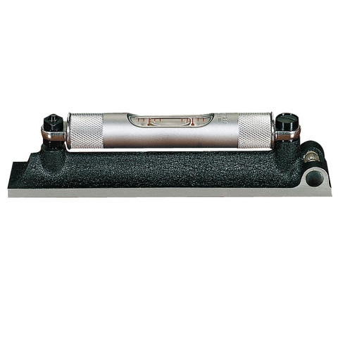

Precision Machinists Level, 6", StarrettMade in United States
  • Starrett machinist improved level
  • Starrett catalog number 98-6
  • Ground and graduated main vials
  • Cross test vial
  • 0.005" per foot (0.42 mm per meter) accuracy
Part Number: 1846
Weight: 0.90 lb
Price: $203.00
PayPal Credit
These levels have ground and graduated main vials, and a cross test vial. These vials are adjustable to a positive setting and are housed in a satin chrome brass tube with a friction-fit closing cover to prevent breakage.
The base of the levels features an involute groove running the length of the base, which provides a reliable seat for round work such as pipes or shafting. With the cross test vial, it is possible to simultaneously level in both directions. This prevents inaccuracies in the main vial reading caused by canting the level sidewise on round work.
The main level vials have graduations that are approximately 80-90 seconds or .005" per foot (0.42 mm per meter). There are five, six, or seven lines on each side of the bubble, depending on the base length.
These are the finest levels available, used for precision work that is typically required in industry. They all have these features:
