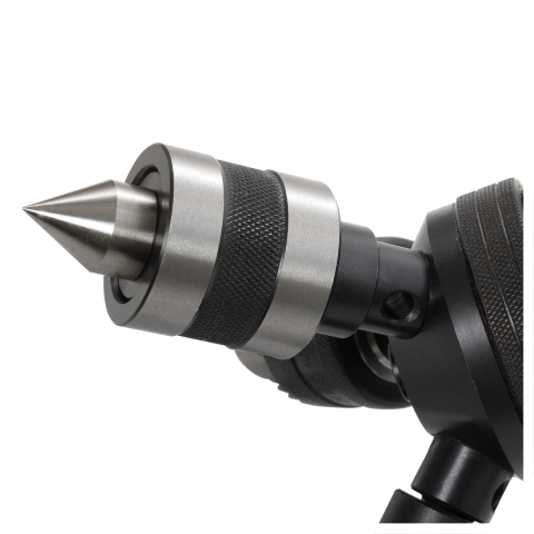

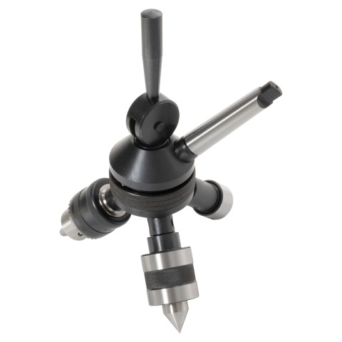

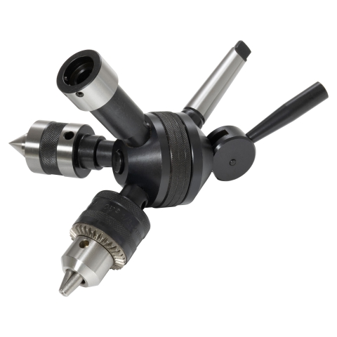

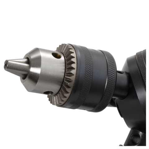

Turret Tool Holder, 2MT Tailstock, 3 Heads
- Three head turret tool holder
- Mounts in 2MT tailstock
- Equipped with 3MT arbor sleeve
- Heads include 1 drill chuck, 1 live center, and 1 die holder
- Quick locking lever for rapid tool changing

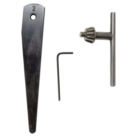

Each head is mounted to the turret by a threaded post 1/2" x 20TPI. The drill chuck is rated for 1.5mm - 13mm (0.06" - 0.51"). The chuck comes with a chuck key.

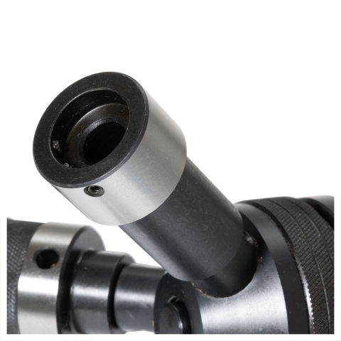

The reversable die holder supports standard 20mm (13/16") diameter round dies on one side and 25mm (1") dies on the other. An Allen wrench is included for locking the die.
The turret has a slight ratchet to ensure that the tool is positioned correctly in relation to the quill.

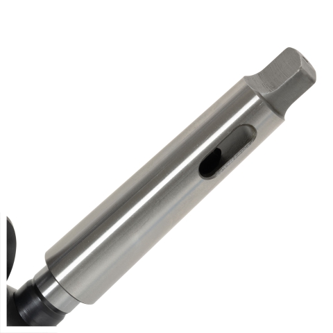

In addition, the holder comes with a 3MT sleeve that slides over the 2MT arbor for use on machines with a 3MT tailstock. This sleeve is accompanied by a quick removal wedge.
A tailstock turret tool holder us useful for a wide range of tasks. It enables quick seamless changing of tools without refitting items into the tailstock. This minimizes downtime thereby enhancing productivity.
