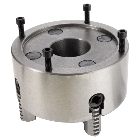

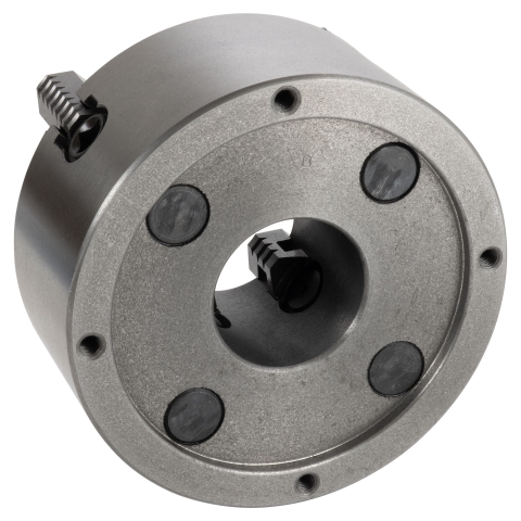

- Plain back mounting, 4-hole mounting pattern

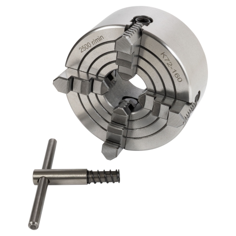

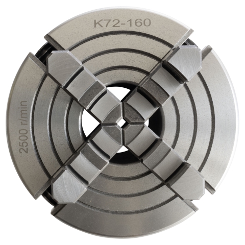

6 inch, 4-Jaw independent lathe chuck.
Each jaw is independently adjustable and reversible.
This chuck has a 1.77" (45.0 mm) through hole. The chuck can hold work up to 6.30" (160 mm) in diameter.
This is a plain back chuck and requires a backplate adapter to mount it.

| Rated Capacity, Inside Jaws | 0.31" - 3.15" (8.0 mm - 80.0 mm) |
| Rated Capacity, Outside Jaws | 1.97" - 6.30" (50.0 mm - 160.0 mm) |
| Diameter, Overall | 6.30" (160.0 mm) |
| Registration Recess Diameter | 5.12" (130.0 mm) |
| Registration Recess Depth | 0.20" (5.0 mm) |
| Bolt Circle Diameter | 5.71" (145.0 mm) |
| Center Hole Diameter | 2.17" (55.0 mm) |
| Height | 2.95" (75.0 mm) |
| Number and Size of Bolts | 4 M8 |
| Max RPM | 3800 RPM |
| Chuck Designation | K72-160 |
