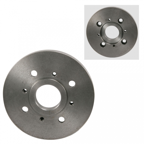

  • Fits 6" 4-Jaw Lathe Chucks with 65 mm Registration Recess
  • DO NOT BUY THIS FOR LMS CHUCKS 2038 and 2028
  • Can Use with 6" Chuck on Flange for 4" Chuck with 72 mm Registration Boss
  • Works on 8x12 and 8x14 Lathes
Part Number: 4913
Weight: 4.69 lb
Price: $29.95
This adapter mounts a 6" 4-jaw lathe chuck with a 65 mm registration recess on a flange for a 4" chuck with a 72 mm registration boss. It works on 8x12 and 8x14 lathes as well as the Harbor Freight 5980 multipurpose machine. It also fits the SIEG C4 and SC4 lathes.
Outside Diameter Ø 6.5" (165 mm)
Center Hole Ø 1.8" (45 mm)
Spindle Side Registration Recess Ø 2.8" (72 mm)
Spindle Side Bold Circle Ø 3.3" (84 mm)
Chuck Side Registration Boss Ø 2.6" (65 mm)
Chuck Side Bolt Circle Ø 3.7" (95 mm)
Chuck Mounting Holes 4
