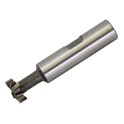

T-Slot Cutter, 8 mm T-slot, HSS
  • For 8 mm T-slots (the width at the top of the T-slot)
  • Cutting diameter 9/16", cutting width 15/64"
  • Neck diameter 17/64", shank diameter 1/2", bolt size M6
  • Undercut length 35/64", OAL 2-19/32", 6 teeth
  • Positive radial rake, right and left-hand spiral
Part Number: 5194
Weight: 0.14 lb
Price: $22.95
T-slot cutting tools are designed to make T-slots in tables and beds.
Two milling cutters are required for milling T-slots, an end mill and a T-slot cutter. An 8mm vertical slot is milled into the piece so that the neck and shank of the T-slot cutter can enter.
Our high speed steel 8mm T-slot cutters have positive radial rake, right and left hand spiral with alternate side cutting teeth for maximum chip clearance.
T-Slot Width 0.315" (8.00 mm)
Cutting Diameter 0.563" (14.30 mm)
Cutter Width (Depth) 0.234" (5.95 mm)
Bolt Size M6
Neck Diameter 0.266" (6.75 mm)
Shank Diameter 0.50" (12.7 mm)
Undercut Length 0.547" (13.89 mm)
Overall Length 2.5938" (65.883 mm)
