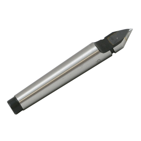

Dead Center, 1MT, Carbide Tip, Half-Notched
- Made of tool steel, hardened and ground
- Carbide tipped, 60° point
- +/- .0002" TIR
- 0.475" (12.065 mm) diameter
- 3.15" (80 mm) overall length, 0.30" (7.62 mm) height
This center is made from hardened steel and ground for accuracy. The point is a 60º included angle.
The diameter is 0.475". The overall length is 3.15".
This product works with lathes with a 1 Morse Taper spindle taper and a 1 Morse taper tailstock taper including:
- Sherline 4000/4100 3.5x8 Lathe
- Sherline 4400/4410 3.5x17 Lathe
- Prazi MD200 4x8 Lathe
- Proxxon PD 230/E 4.4x9 Lathe
- Grizzly M1015 Shop Fox 6x10 Micro Lathe
- Micro-Mark 85181 MicroLux 6x10 Micro Lathe
- SIEG C1 6x10 Micro Lathe
- Woodstock International M1015 Shop Fox 6x10 Micro Lathe
- Emco Compact 5 5x14 Lathe
- Prazi SD300 5x12 Lathe
- Craftsman & Atlas 612 6x18 Lathe
