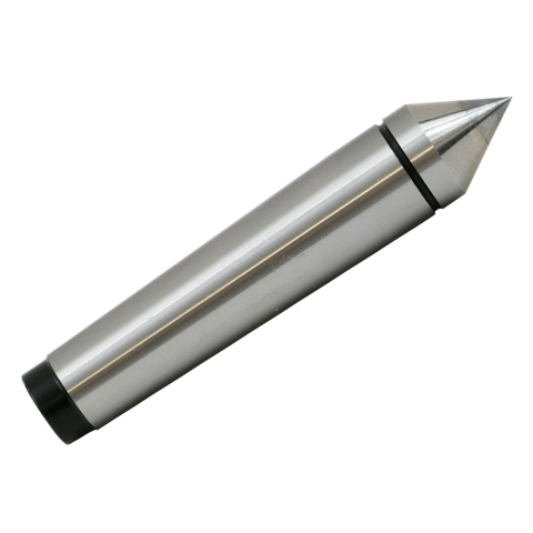

Dead Center, 3MT, Carbide Tip
  • Made of tool steel, hardened and ground
  • Carbide tipped, 60° point
  • +/- .0002" TIR
  • 0.938" (23.825 mm) diameter
  • 4.92" (125 mm) overall length
Part Number: 5477
Weight: 0.80 lb
Price: $18.95
This center is made from hardened steel and ground for accuracy. The point is a 60º included angle.
The body diameter is 0.938" and the largest diameter of the tip is 0.472". The overall length is 4.92".
Use this to turn between centers, using a live center in the tail stock, and a lathe dog to drive the part.
This product works with lathes with a 3 Morse taper spindle taper including:
