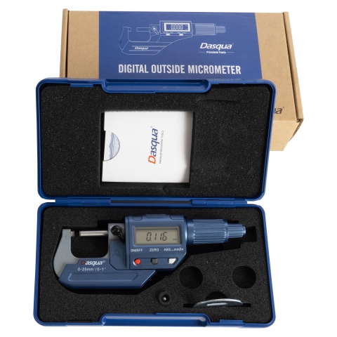

Micrometer, 0-1" Digital IP65, Dasqua
- Measurement range: 0-1"
- Resolution: 0.00005"/0.001mm
- Accuracy: 0.00015"/0.003mm
- IP65 Water, Oil & Dust Resistance

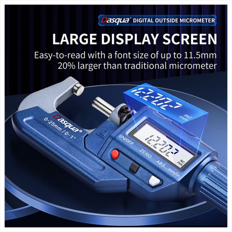

- Large LCD display
Easy to read digital electronic micrometer with a large LCD digital display + Vernier scale reading in the spindle. The digital display has two measuring modes Metric/Standard as well with absolute and incremental modes for each.

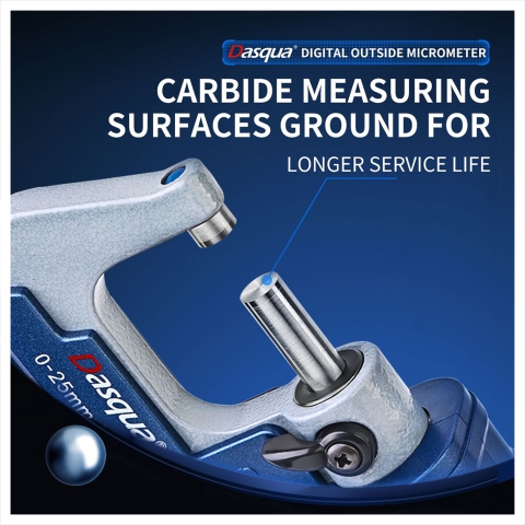

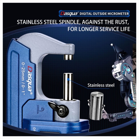

The spindle has carbide measuring faces and the resolution of 0.00005"/0.001mm. Measurement range is 0-1" and the unit is rated as IP65 (water, oil and dust resistance).

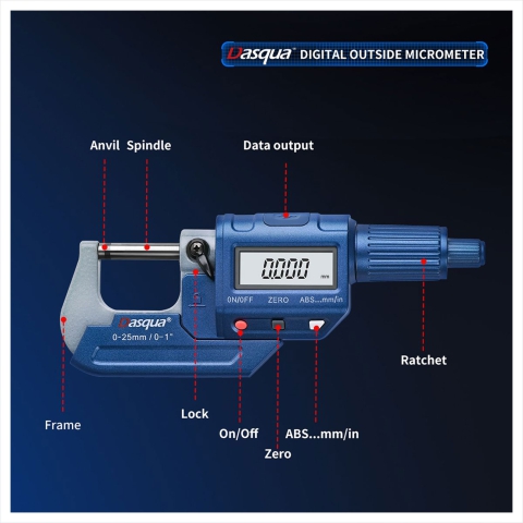

There are three buttons; ON/OFF Zero, ABS in/mm to switch between inches and mm with absolute and incremental measurement options for each.
The micrometer has an auto shut-off.
Comes with an adjustment wrench and a 3V CR 2032 lithium battery and a ball adapter.
| Range | 0" - 1" (0 mm - 25 mm) |
| Resolution | 0.00005" (0.0013 mm) |
| Accuracy | 0.00015" (0.0038 mm) |
| Clear to Zero | Yes |
| Inch/mm Display | Yes |
| International Protection Rating | IP65 |
| Incremental/Absolute | Yes |
