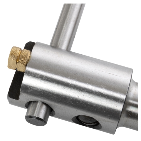

  • Three piece tap wrench set with reversible t-handles

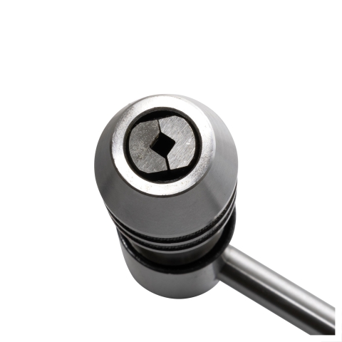

  • For holding taps, drills, reamers, and other small tools to be turned by hand
  • Fits fractional thread taps from 1/16" to 1/2"
  • Made of tool steel
  • Jaws are hardened and tempered

Ideally suited for tapping in a limited space, these tap wrenches may be shifted from a left position to a right position with the pulling of a center locking pin.

The body of this T-handle tap wrench is centered, enabling the worker to use it on lathe centers or on an upright drilling machine to start the tap straight. The jaws conform to the tool being held, making it rigid and less apt to loosen. They are properly heat treated to withstand ordinary shop use.
These tools are designed to hold square shanks. Round shanks can be gripped, but care must be used. Excessive tightening may break the binding nut.
