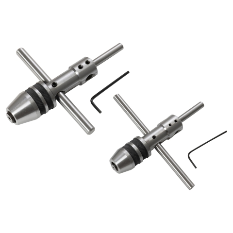

  • Two piece t-handle tap wrench set with pilots
  • Built in pilot allows threading of drilled hole without moving workpiece
  • Fits fractional thread taps from 5/32" to 1/2" (3.97mm to 12.7mm)
  • Improves accuracy and efficiency of tapping
  • Use in mills, drill presses, and lathes
Part Number: 6699
Weight: 1.35 lb
Price: $14.95
Piloted tap wrenches allow for accurate alignment of tapping into drilled holes without moving work piece.
Once a hole is drilled, mount the tap into the chuck and tap directly into the drilled hole, ensuring alignment and quickening the tapping function.
Use in drill presses, mills and lathes.
The wrenches hold the following size taps:
- 5/32" to 1/4" (3.97mm - 6.35mm)
- 1/4" to 1/2" (6.35mm - 12.70mm)
The T-handles may be moved to left or right positions or left centered as needed.
These tools are designed to hold square shanks. Round shanks can be gripped, but care must be used. Excessive tightening may break the binding nut.
