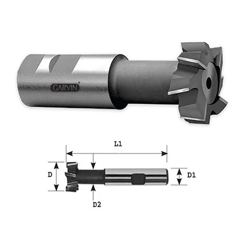

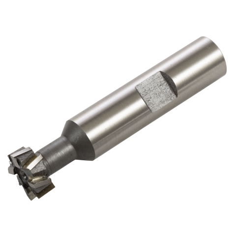

  • For 1/4" T-slots (measured at the top of the T-slot)
  • Cutting diameter 9/16", cutting width 15/64"
  • Neck diameter 17/64", shank diameter 1/2", for bolt size 1/4"
  • Undercut length 3/4", OAL 2-19/32, 8 teeth
  • Positive radial rake, right and left-hand spiral
Part Number: 6705
Weight: 0.15 lb
Price: $76.95
T-slot cutting tools are designed to make T-slots in tables and beds.
Two milling cutters are required for milling T-slots, an end mill and a T-slot cutter. A 1/4" vertical slot is milled into the piece so that the neck and shank of the T-slot cutter can enter.
Our high speed steel 1/4" T-slot cutters have positive radial rake, right and left hand spiral with alternate side cutting teeth for maximum chip clearance.
T-Slot Width 0.25" (6.3 mm)
Cutting Diameter 0.562" (14.29 mm)
Cutter Width (Depth) 0.234" (5.95 mm)
Bolt Size 1/4"
Neck Diameter 0.266" (6.75 mm)
Shank Diameter 0.50" (12.7 mm)
Undercut Length 0.547" (13.89 mm)
Overall Length 2.5938" (65.883 mm)
