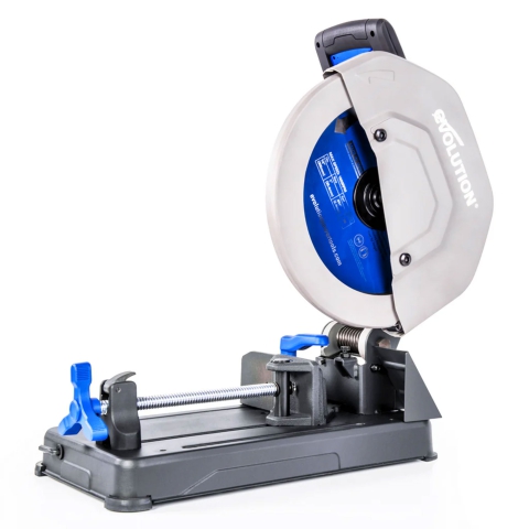

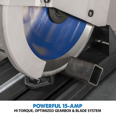

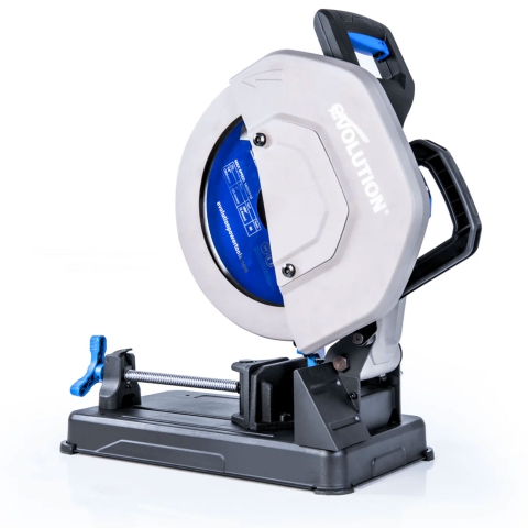

  • 14 Inch diameter blade with 15A (120V 60 Hz) Motor
  • Lightweight stamped steel base

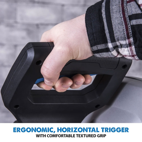

  • Ergonomic, ambidextrous trigger with textured grip

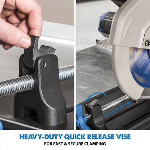

  • Accurate, durable cast steel vise with quick-release
  • Lock down pin & carry handle for easy transportation
Part Number: 6746

This 14" metal cutting chop saw is perfect for a small shop or as a portable work site saw. With a powerful 15A motor this saw can cut a variety of metals and woods.

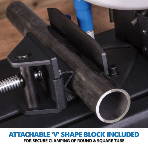

Cutting operations are aided by a quick-release vise with a robust threaded rod for fast and secure clamping. In addition, an accurate and durable cast steel vice with 0° - 45° miter capacity. An attachable "V" shaped block is included for secure clamping of round and square tube stock.

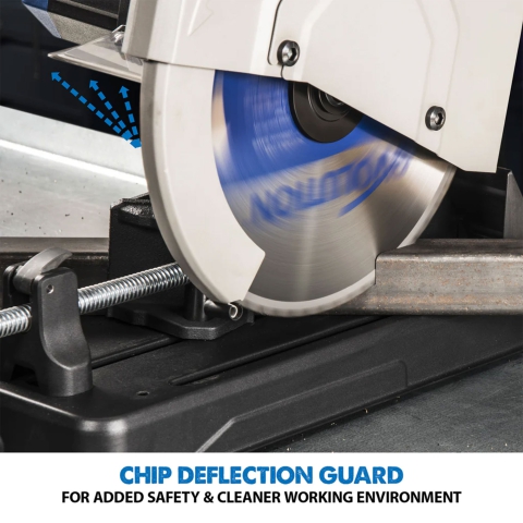

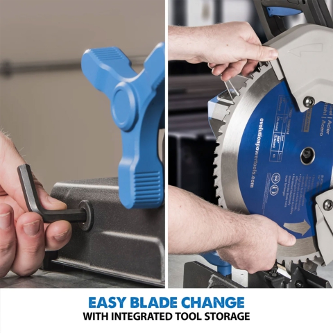

The saw is designed with an ergonomic, ambidextrous trigger that has a comfortable textured grip. A chip deflector directs chips away from the operator and also reduces cleaning time when finished. Also, the easy blade change design allows for quick transitions between different types of materials.

The saw comes with a 66 tooth mild steel TCT Blade, Hex Key for blade changes and V-block for round and square stock.
