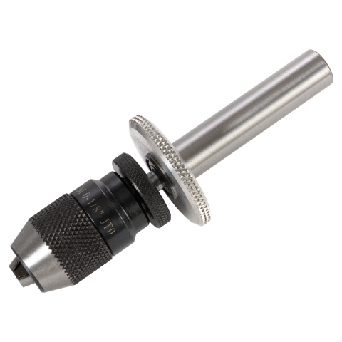

  • Fingertip control for drilling small holes
  • Helps prevent drill breakage
  • 0 Jacobs Taper, 1/2" diameter straight shank
  • Spring loaded 3/4" travel fits most drills, mills, lathes or jig borers
  • Capacity: 0" - 1/8" (0 - 3mm ) Keyless drill chuck
Part Number: 6752
Weight: 0.40 lb
Price: $279.95
PayPal Credit
Sensitive drill feed designed for drilling small holes combined with a 0"-1/8" (3 mm) capacity keyless drill chuck.
To use the sensitive drill feed, grasp the knurled ring and pull it down to feed the drill into the workpiece. The internal spring retracts the drill when the ring is released.
No chuck key is required with this self-tightening design. The chuck is made from hardened tool steel to ensure accuracy and extended life.
The rated capacity of the drill chuck is 0 to 3 mm. Number 0 Jacobs taper mount. 0.003" (0.075 mm) overall maximum runout.
