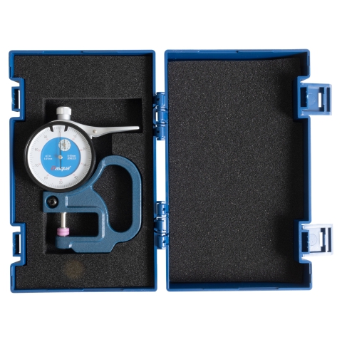

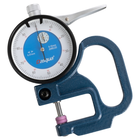

  • Dial indicator thickness gage

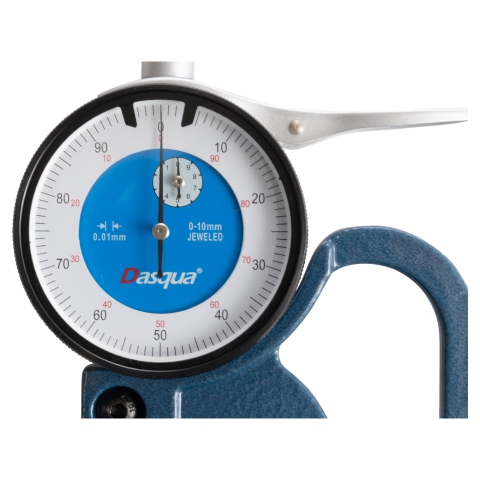

  • Range: 0-10 mm (0-0.39")
  • Graduation: 0.01 mm (0.0004")

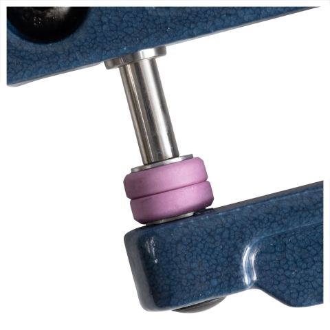

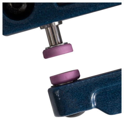

  • Ceramic measuring faces
  • Light weight frame with spindle lifting lever
Part Number: 6813
Weight: 1.20 lb
Price: $59.95
Thickness gages are attachments to dial indicators and offer quick efficient ways to measure items with a high level of accuracy. This Dasqua thickness gage has an indicator with a range of 0 - 10mm ( 0.39"). The indicator has graduations of 0.01mm (0.0004").
The attachment has a light sturdy lacquered frame with a spindle lifting lever. The measuring faces are ceramic and the stainless spindle is hardened and precision ground.
The depth of the gage is 30mm (1.18") from the center of the spindle to the back of the attachment.
This tool is ideal for measuring thin materials such as metal plate, plastic, glass, rubber, fabric, paper, and other materials under 10 mm in thickness.
