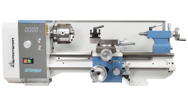

The LittleMachineShop.com model 7600 HiTorque9x20 Bench Lathe is the best in its class. It is a significant step up in size, rigidity, and power compared to a mini lathe. This bench top lathe provides a larger bed, more swing over bed, more horsepower, and more rigidity. Compare our standard features and specs to others in this size and price range.
NEW larger spindle through hole - 1.1" (28 mm) accepts 1" stock.
NEW greater swing from 8.5" to 9"
The 1000 Watt brushless spindle drive motor provides tremendous low-end torque. And you can vary the speed from 100 rpm to 2000 rpm continuously in both directions. There are no gears to shift. NSK brand Japanese-quality spindle bearings ensure years of quiet operation.
NEW easy-to-read LED display with built in speed readout allows you to stop and then restart the lathe at a pre-selected speed.

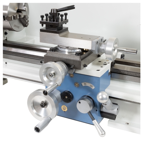

A power cross feed is a feature not found in other lathes of this size. The cross feed and compound rest dials are graduated in 0.001" and advance 0.050" per turn. The metal lathe is equipped with a 4-way indexing tool post set for 10 mm tools.

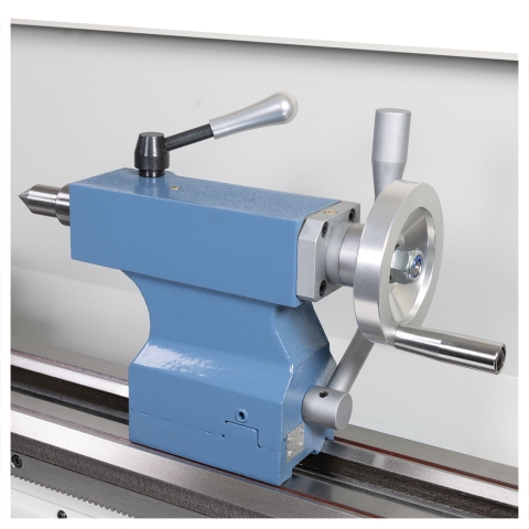

  • Cam-lock tailstock

"HiTorque 9x20 Bench Lathe Carriage and Compound Rest
"HiTorque 9x20 Bench Lathe Tailstock
"HiTorque 9x20 Bench Lathe Tailstock Alternate View

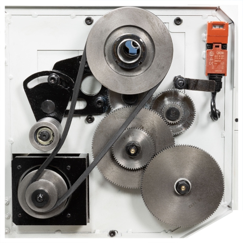

"HiTorque 9x20 Bench Lathe Change Gears
"HiTorque 9x20 Bench Lathe Accessories
"HiTorque 9x20 Bench Lathe Change Gear Set

  • Change gear set - 18 Gears - 35, 40, 45, 49, 50(x2), 55, 56, 60, 70, 80, 85, 87, 90, 94, 100(x2), 127 teeth
  • Gears installed on the lathe include 30, 60, 66(x2), 120(x2) teeth
