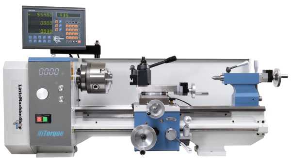

HiTorque 9x20 Deluxe Bench Lathe, LED Display

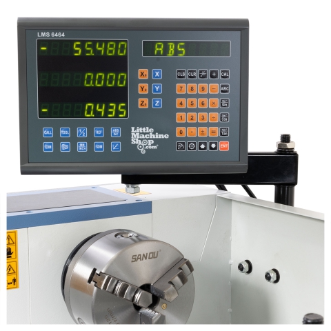

The Deluxe model includes digital readouts (DRO) on the compound rest, cross slide, carriage, and tailstock. Cross slide and carriage DROs feed data from mounted scales to a large display, while compound and tailstock use digital readouts on leadscrews. The DRO system measures in increments .0002" and comes factory installed on the lathe. All DROs read equally accurately in inches and mm.

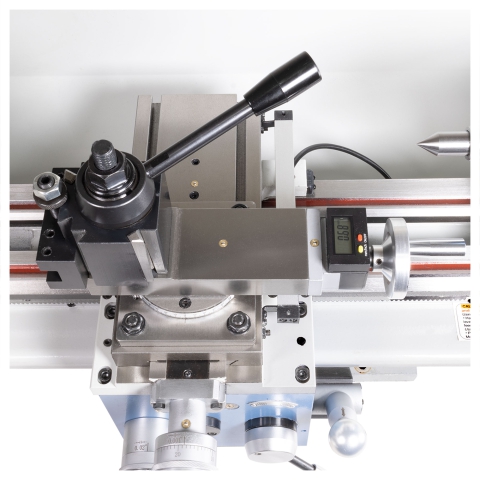

The Deluxe model also includes an AXA quick change tool post set with five tool holders; anodized aluminum hand wheels; aluminum knobs and levers; and a heavy-duty splash guard that covers the full bed length. In addition, the compound rest is modified to better accommodate the quick-change tool post.

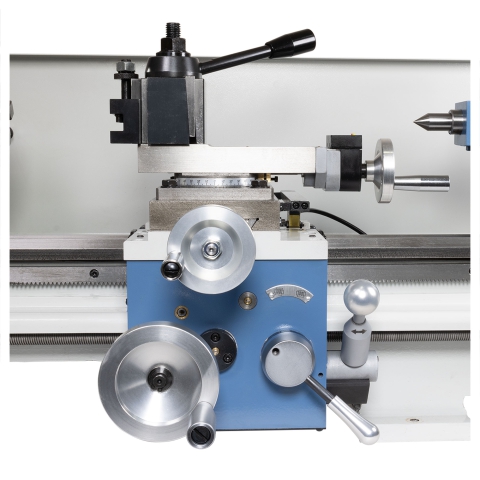

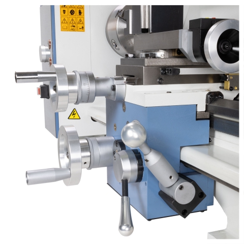

"HiTorque 9x20 Deluxe Bench Lathe Carriage
"HiTorque 9x20 Deluxe Bench Lathe Power Feed and Carriage Handwheels

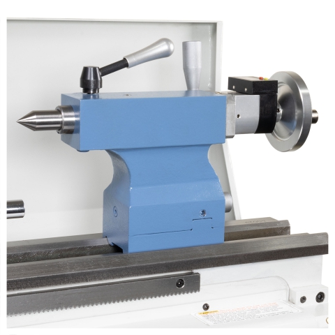

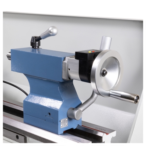

"HiTorque 9x20 Deluxe Bench Lathe Tailstock
"HiTorque 9x20 Deluxe Bench Lathe Tailstock Alternate View

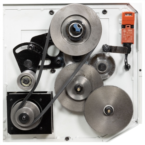

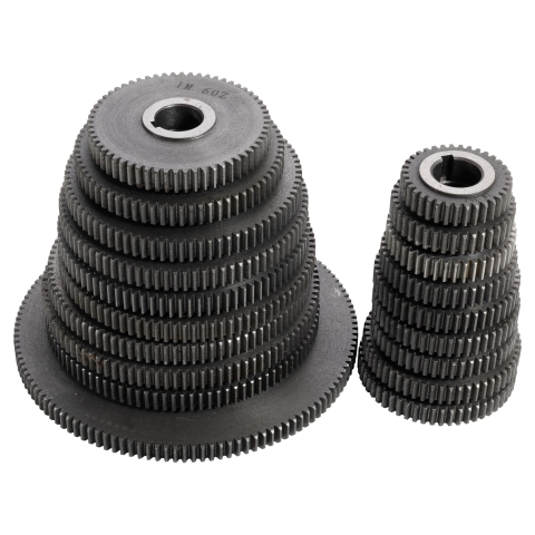

"HiTorque 9x20 Deluxe Bench Lathe Change Gears
"HiTorque 9x20 Deluxe Bench Lathe Compound Rest with Digital Display

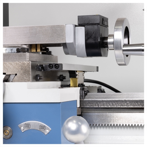

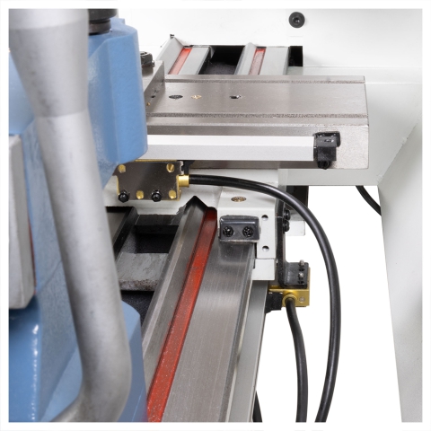

"HiTorque 9x20 Deluxe Bench Lathe Z-Axis DRO Read Head and Scale
"HiTorque 9x20 Deluxe Bench Lathe X & Z-Axis DRO Read Heads and Scales
"HiTorque 9x20 Deluxe Bench Lathe DRO Display

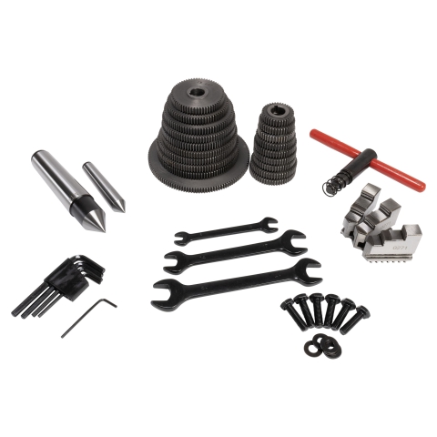

"HiTorque 9x20 Bench Lathe Accessories
"HiTorque 9x20 Bench Lathe Change Gear Set
The HiTourqe 9x20 Deluxe Bench Lathe comes with the following:
  • 5" (125 mm) 3-jaw self centering lathe chuck with two sets of jaws and a chuck wrench
  • AXA quick change tool post set
  • #4 Morse taper dead center for the headstock
  • #2 Morse taper dead center for the tailstock
  • Change gear set - 18 Gears - 35, 40, 45, 49, 50(x2), 55, 56, 60, 70, 80, 85, 87, 90, 94, 100(x2), 127 teeth
  • Gears installed on the lathe include 30, 60, 66(x2), 120(x2) teeth
  • Three open end wrenches: 8/10 mm, 14/17 mm, 17/19 mm
  • Five hex (Allen) wrenches: 2, 3, 4, 5, 6 mm
  • Users Manual
  • Inspection Report
