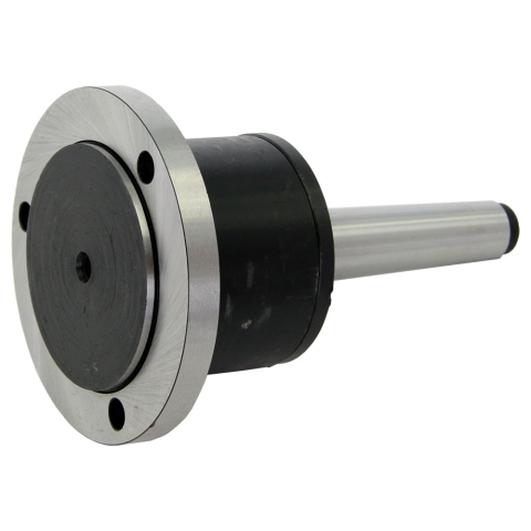

Revolving Tailstock Chuck Adapter, 3" Chuck, 2MT
- CHUCK NOT INCLUDED: Mounts a 3" 3-jaw chuck in the tailstock
- Three ball bearings provide support for heavy duty load and high speed.
- Max Load: 1100 lbs.
- Maximum Rated RPM: 4000
- 2MT standard shank
Use this in conjunction with a 3" 3-jaw chuck in place of a live center. No more center drilling. This works great for long, large diameter work pieces where a live center or steady rest just won't cut it. Three ball bearings for heavy duty loads and relatively high speed.
*NOTE* Chuck is not included, but it works great with our 1187 lathe chuck.
2MT Revolving Tailstock Chuck Adapter ~ back |
2MT Revolving Tailstock Chuck Adapter with chuck attached. |
