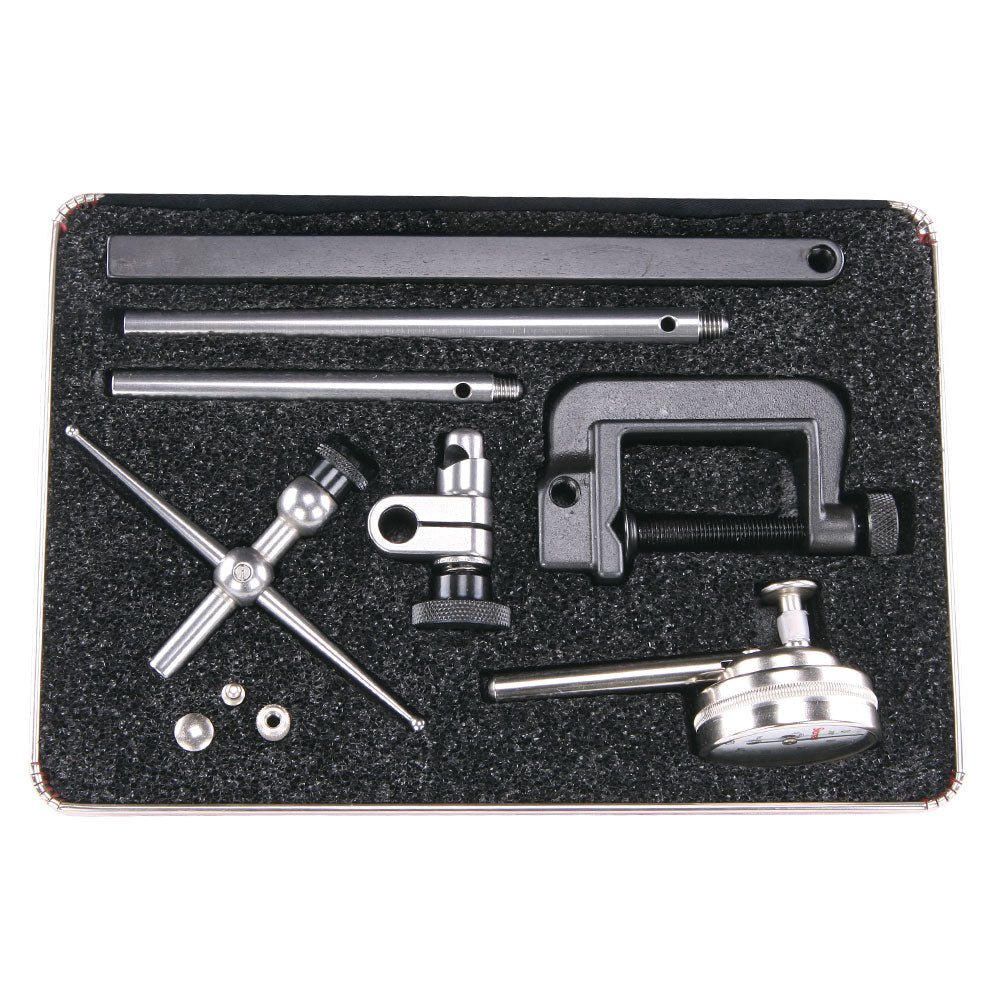

  • Starrett Back-Plunger Dial Indicator
  • Starrett catalog number 196A1Z
  • 0-100 with 3 contact points, adapter, 4 attachments in case
  • Accurate and reliable
  • Rugged, with few moving parts

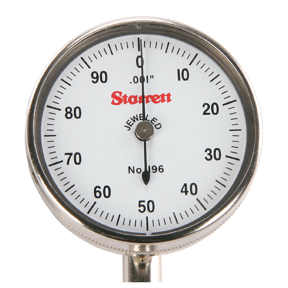

This indicator with graduations to .001" will handle by far the majority of jobs. Shank diameter is 1/4" (6.3 mm).
For full use, first choose the proper contact from the three hardened contact points that are included. Then the contact is brought against the work with enough pressure to give the hand one full turn. Set the hand at zero by rotating the dial with the knurled bezel. This provides one full rotation of the hand both to the right and left of zero, showing a rise or drop in the work and the amount of that variation.

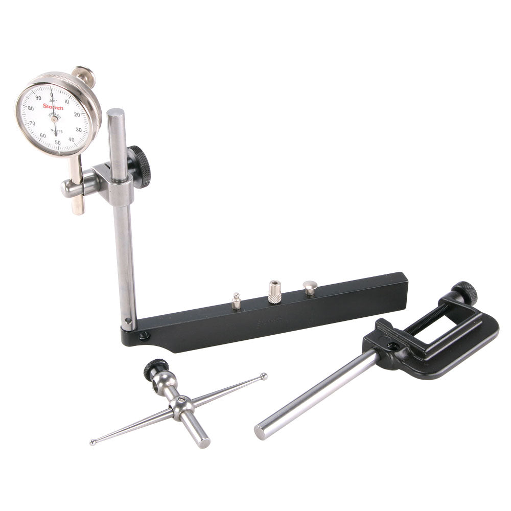

The bar is 0.750" tall, 0.375" wide and 6" long.

Resolution: 0.001" (0.025 mm)
