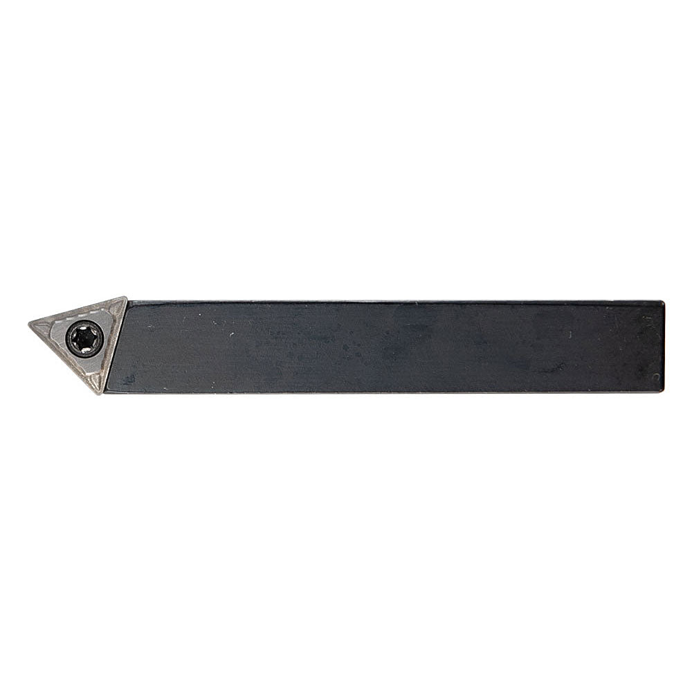

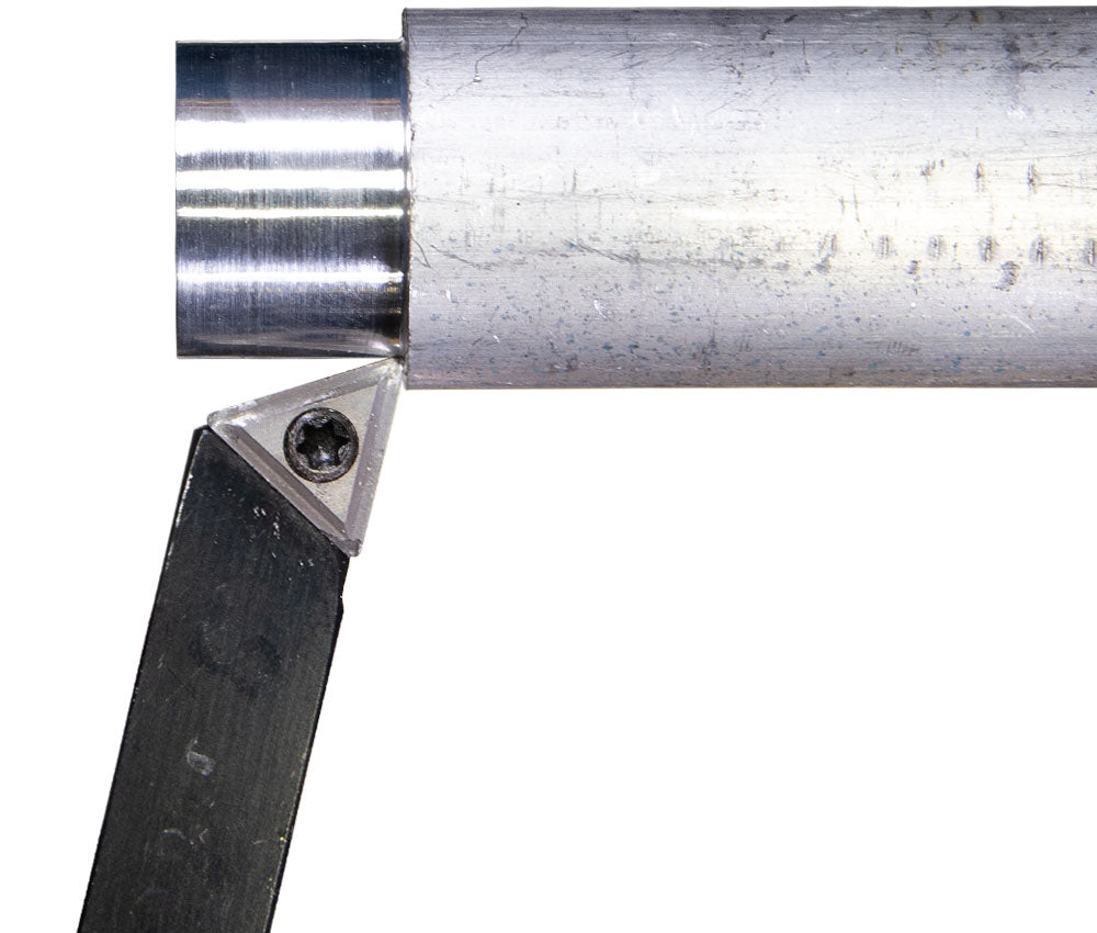

Right Hand Turning Tool
Right hand cutting
A right-hand cutting tool removes metal when moving from right to left. This is the most common turning activity, cutting towards the lathe chuck. The cutting edge is on the left side. Tools where the second letter is "R" are right-hand tools.

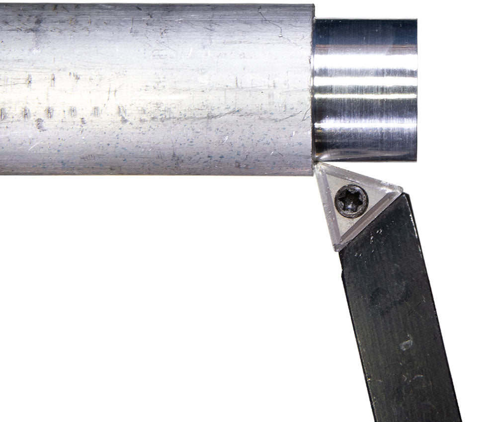

Always cut with the point of the insert. The tool shown is at the proper angle for turning to a 90-degree shoulder. Move right to left to turn the diameter, then move the tool out to face the 90-degree shoulder.

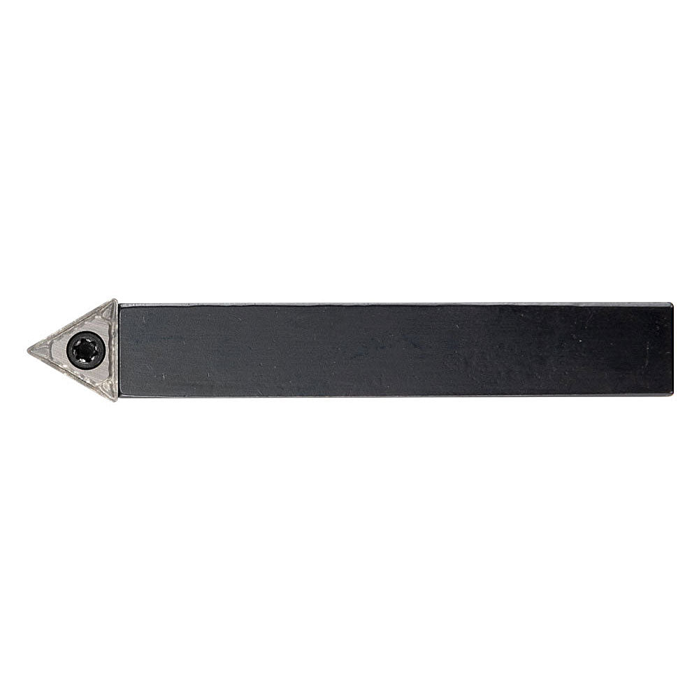

Left Hand Turning Tool
A left-hand cutting tool removes material when moving from left to right. This tool cuts away from the lathe chuck. The cutting edge is on the right side. Tools where the second letter is "L" are left-hand tools.
Always cut with the point of the insert. The tool shown is at the proper angle for turning to a 90-degree shoulder. Move left to right to turn the diameter, then move the tool out to face the 90-degree shoulder.

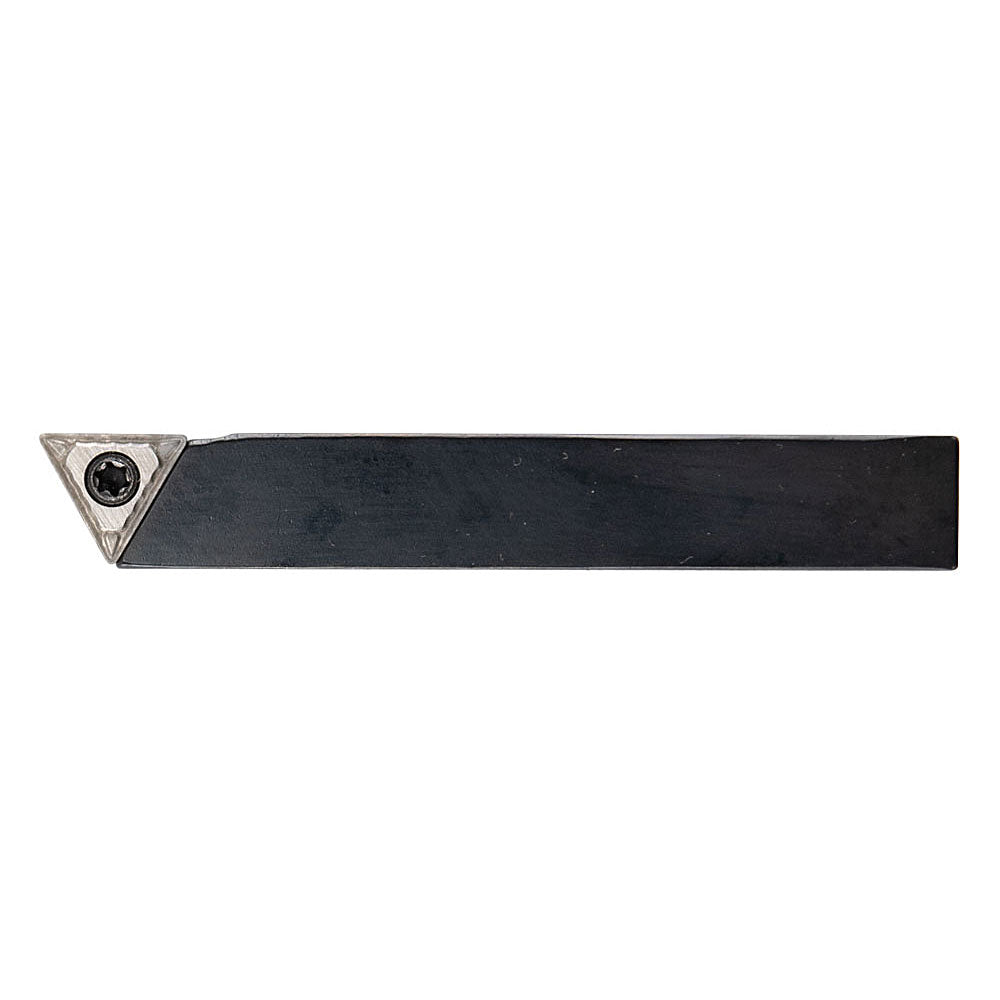

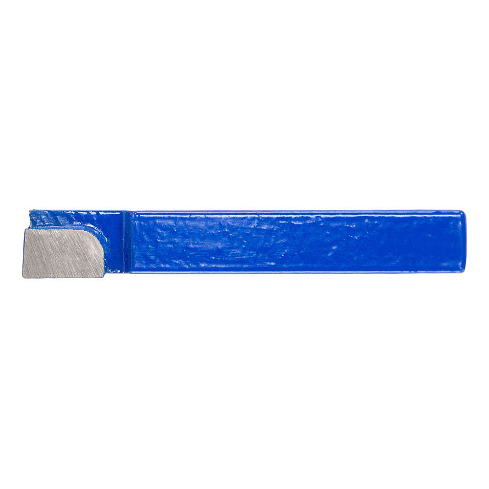

AR Tool Bit

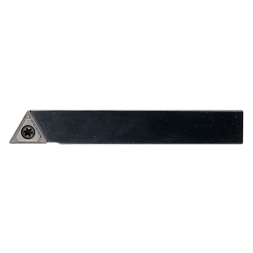

AR Indexable Tool

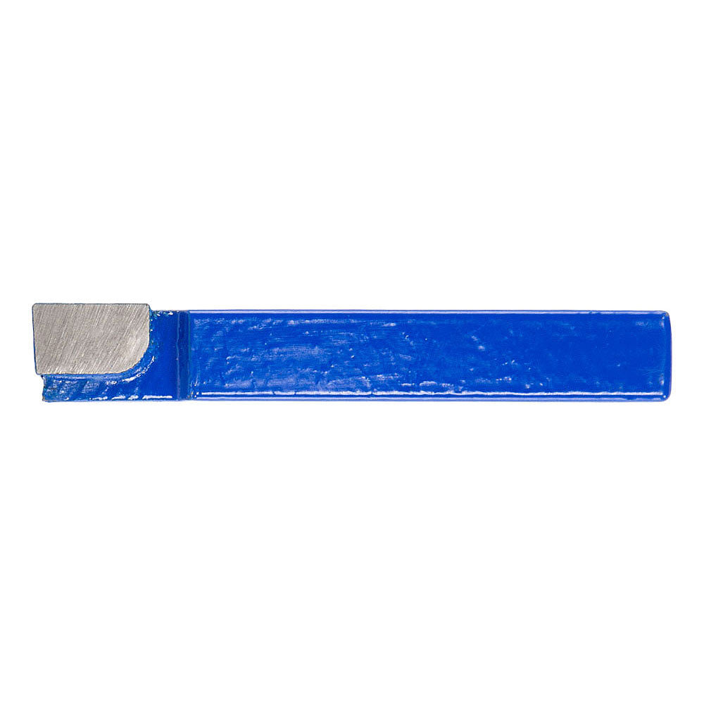

AR Brazed Tool
The AR-style tool has a 0-degree side cutting angle for general machining applications such as turning, facing, and chamfering. It's suitable for machining to a 90-degree shoulder. The cutting edge is on the left for right-to-left feed.

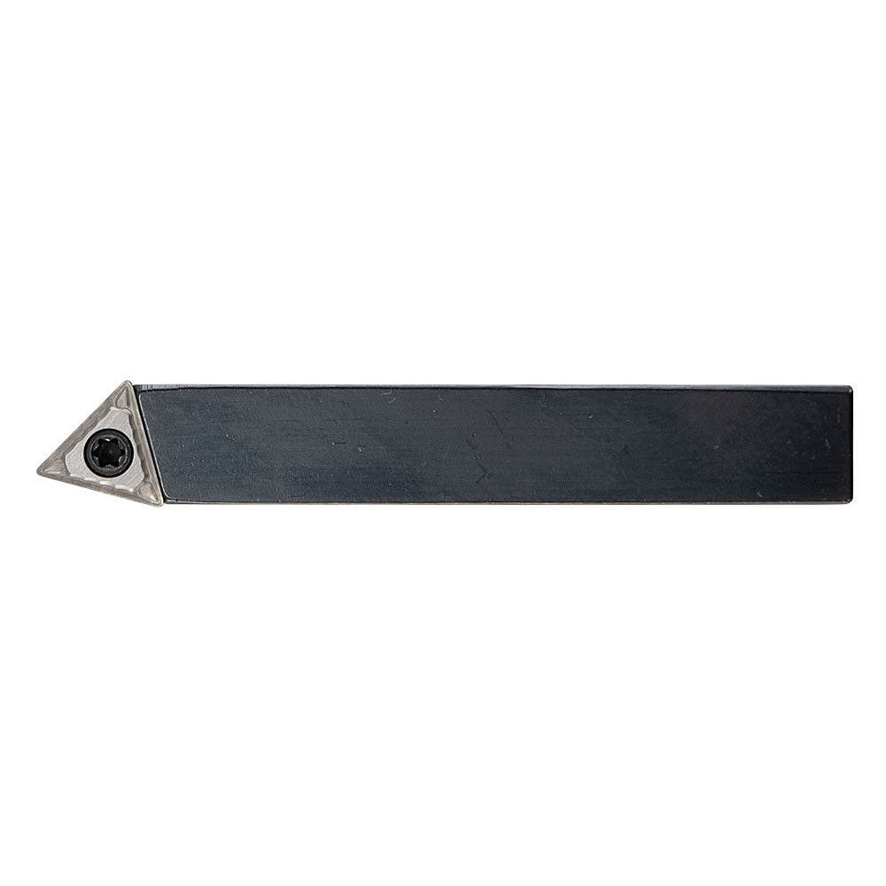

AL Tool Bit
AL Indexable Tool
AL Brazed Tool
The AL-style tool has a 0-degree side cutting angle for general machining applications such as turning, facing, and chamfering. It's suitable for machining to a 90-degree shoulder. The cutting edge is on the right for left-to-right feed.
