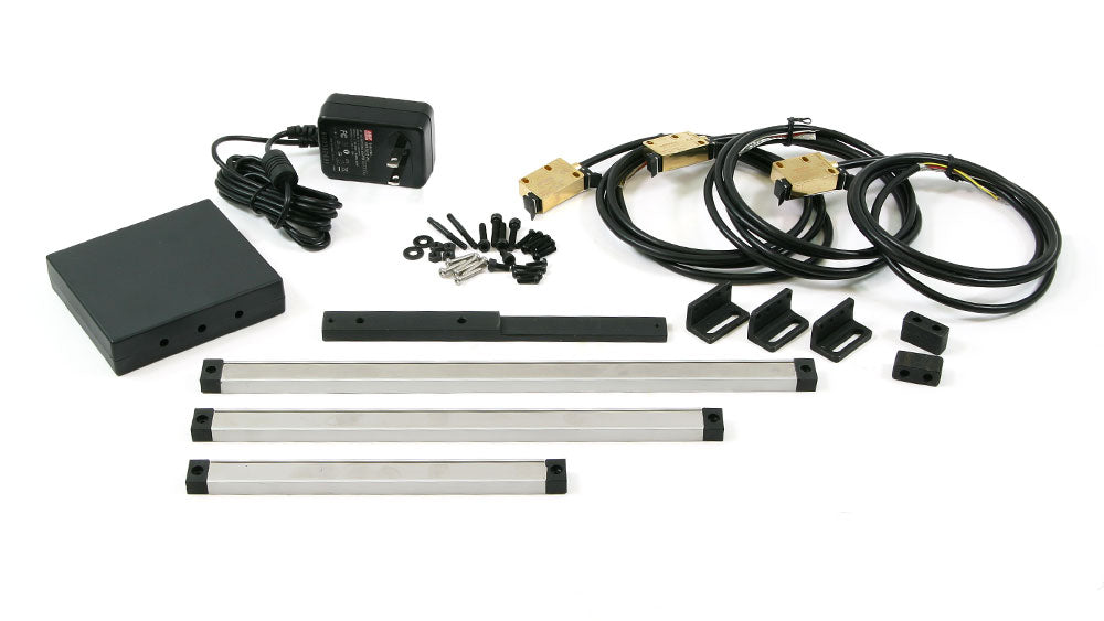

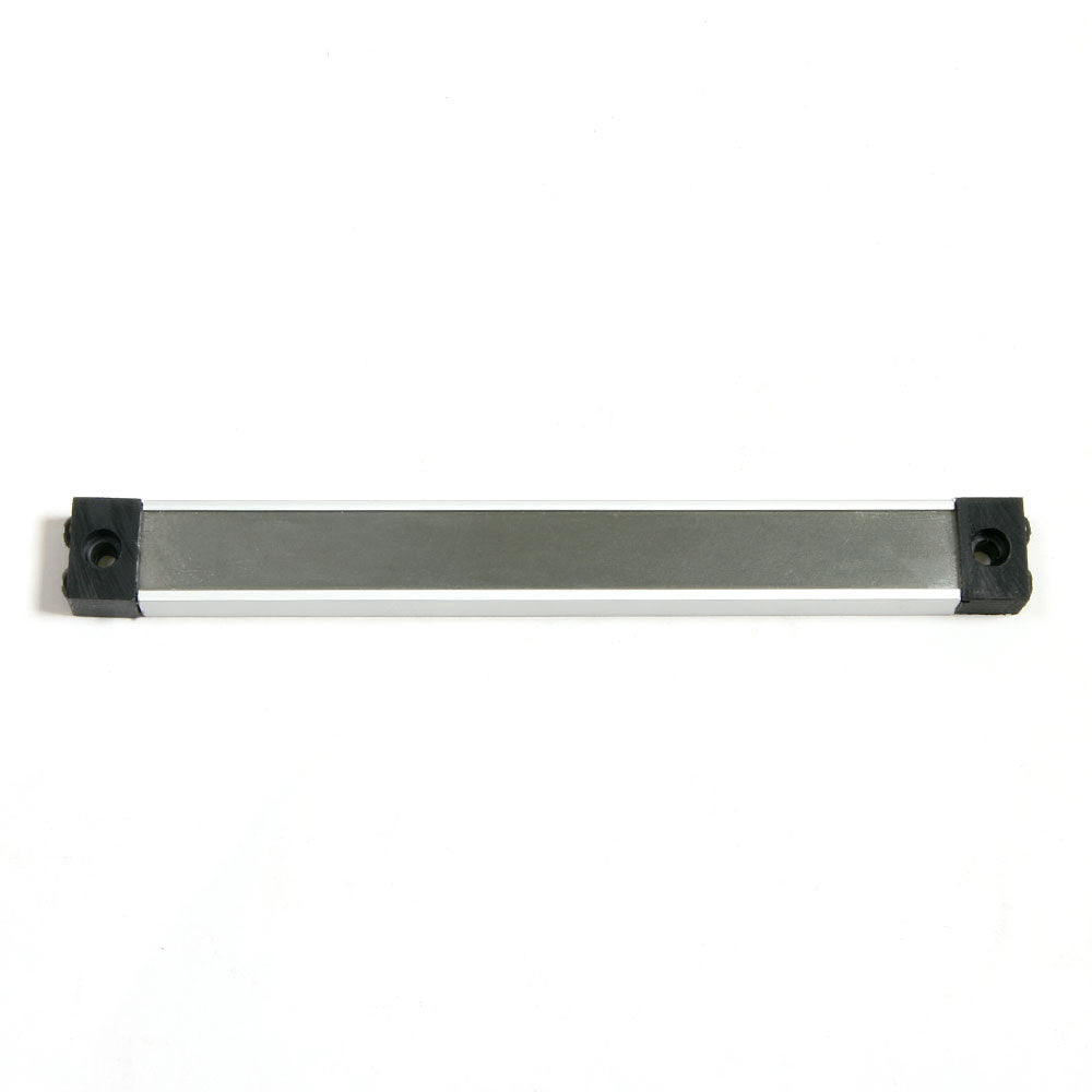

This magnetic technology digital readout package fits all mini lathes from 7x10 to 7x16. Simply cut the long scale to fit.

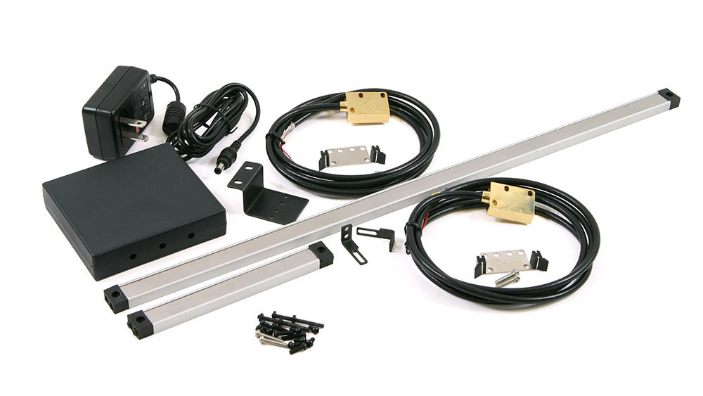

This package includes what you need to put a DRO on most any mini lathe. It includes a two scales, two read heads, and a Bluetooth transceiver and all the mounting brackets and hardware.
