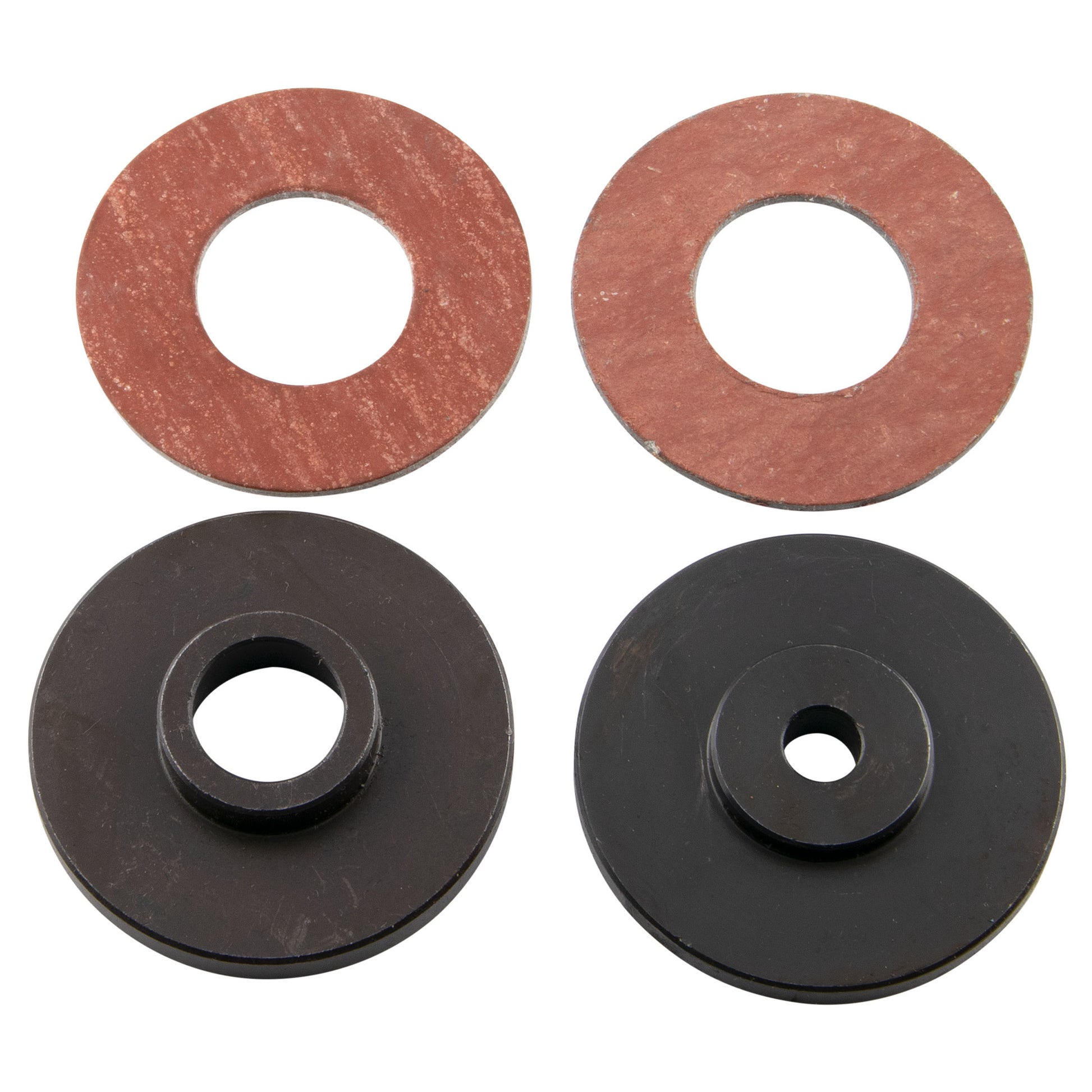

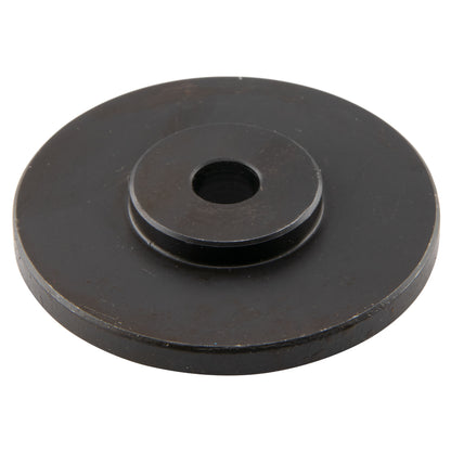

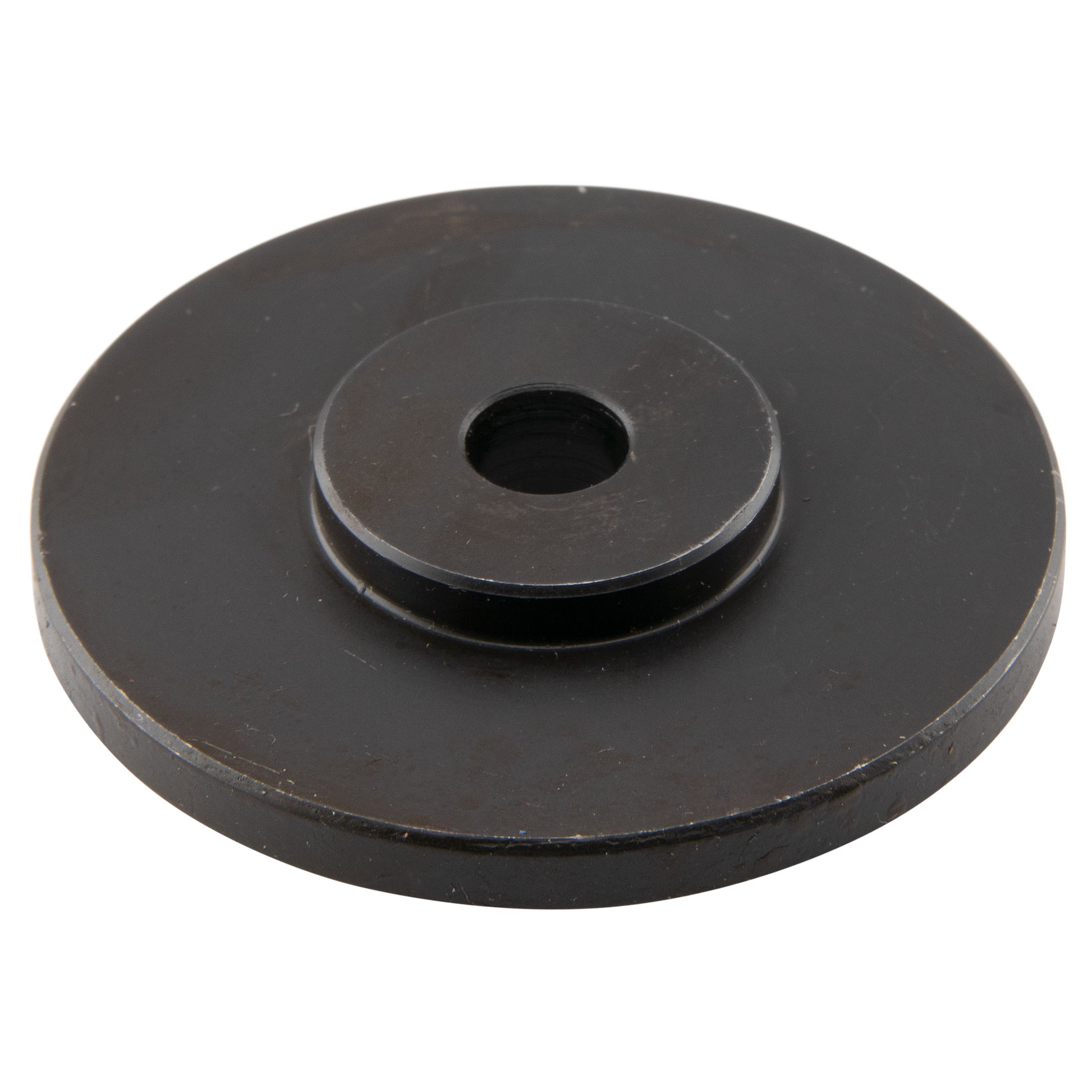

  • Grinding wheel arbor for tool post grinder
  • Two discs and two pads
  • Designed to work with P/N 2001 grinder
  • Part #s 4 and 6 in grinder manual

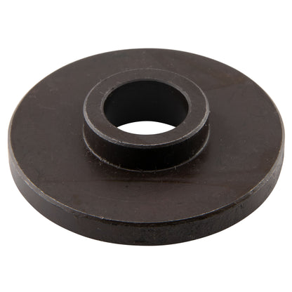

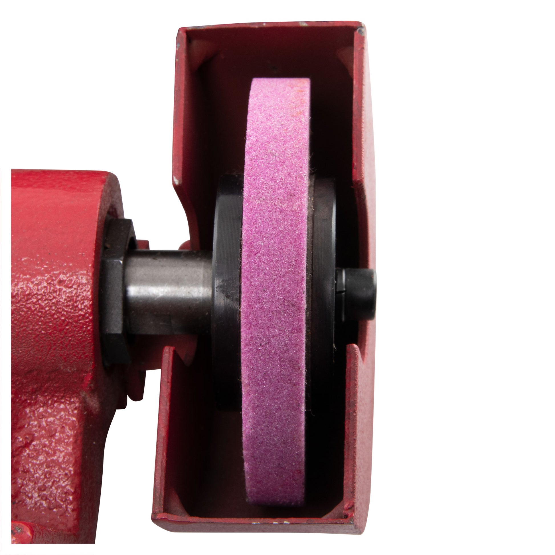

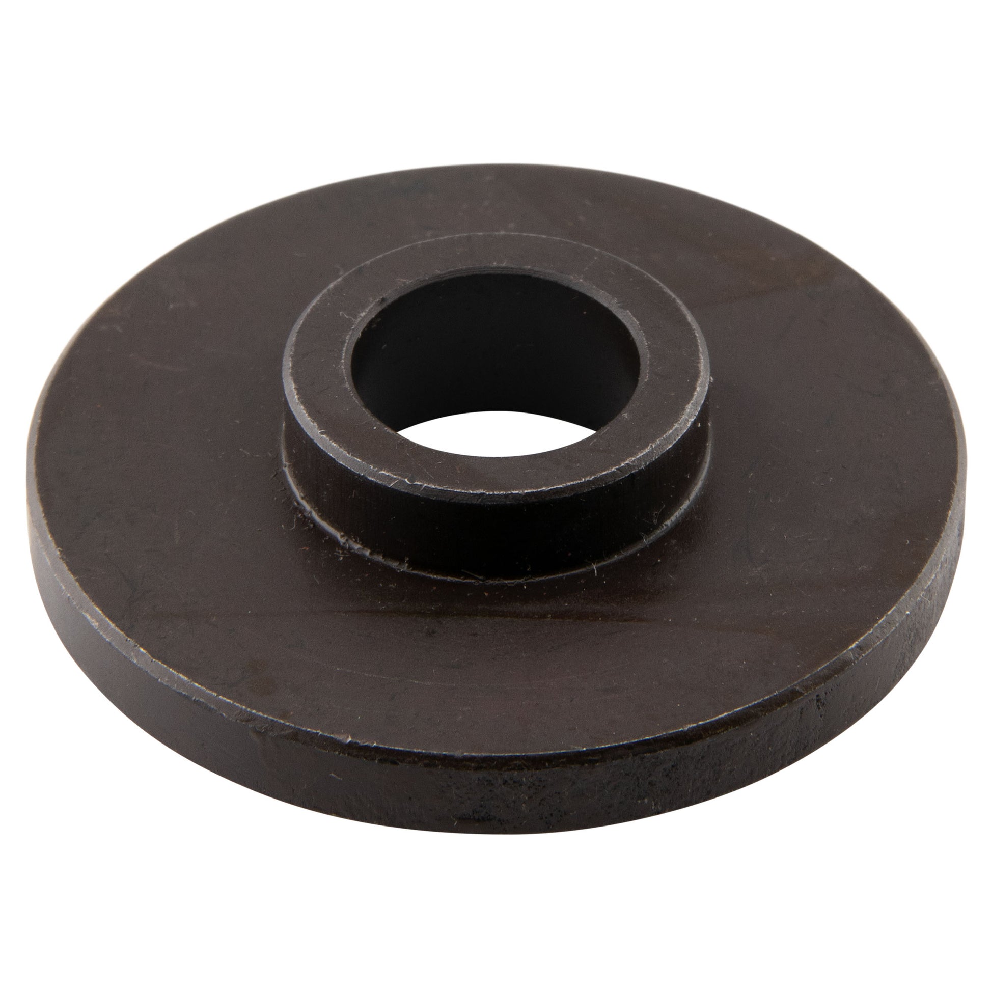

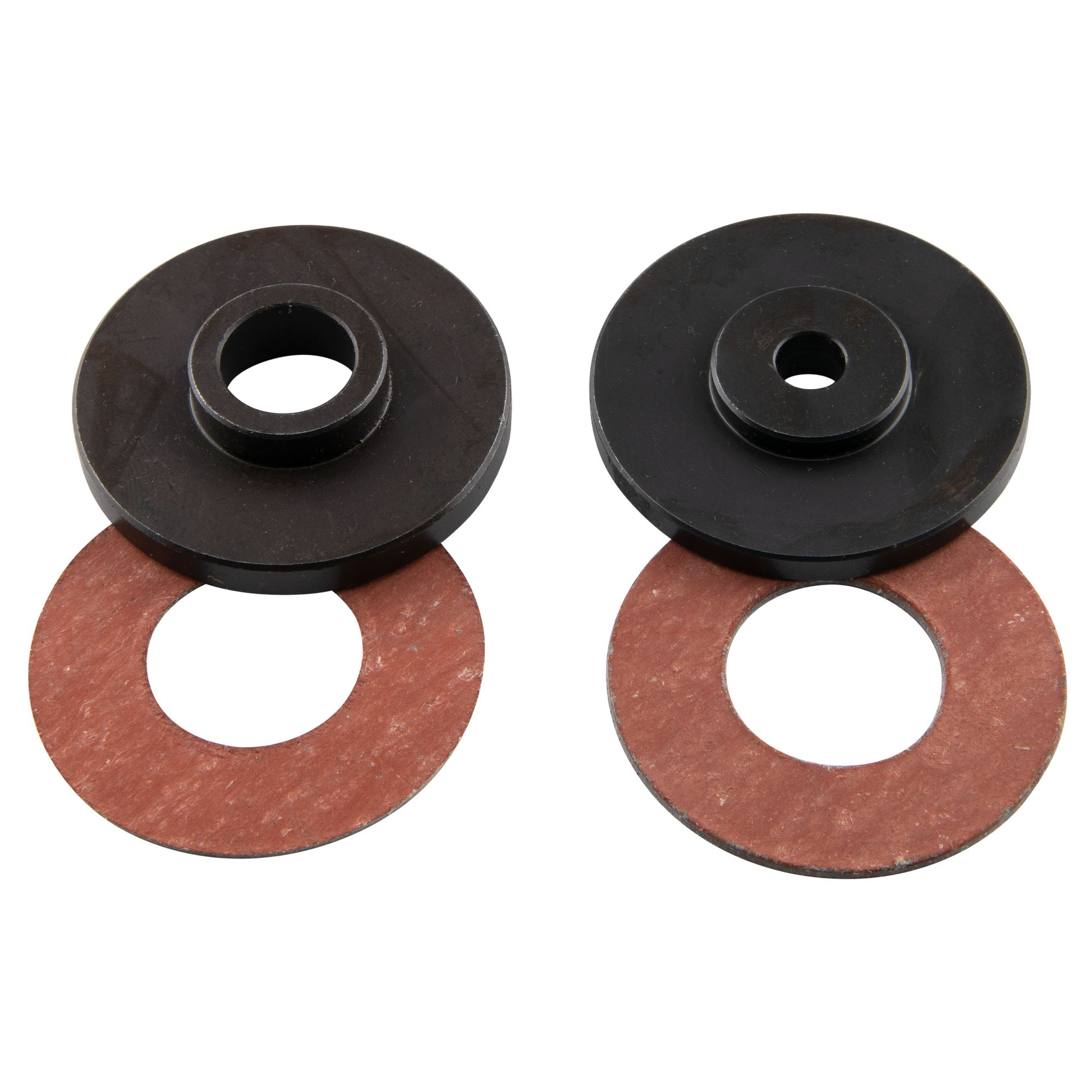

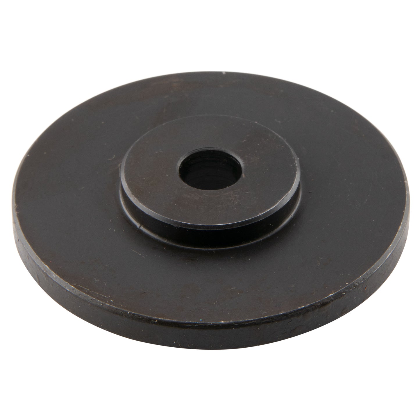

This is the two-piece arbor that retains the grinding wheel on the PN 2001 tool post grinder. It includes the two pads.
The two parts are identified as #4 and #6 in the grinder manual drawing.
Both parts are 45 mm wide with a 20 mm registration to fit into the inside of the grinding wheel. The pads have a 20 mm hole to fit over each part, between the part and the grinding wheel.
Part #4 Width: 1.772" (45 mm)
Part #4 Registration: 0.787" x 0.118" (20 mm x 3 mm)
Part #4 Inside Hole For Bolt: M6
Part #6 Width: 1.772" (45 mm)
Part #6 Registration: 0.787" x 0.197" (20 mm x 5 mm)
Part #6 Inside Hole: 0.787" (20 mm)
Pads Width: 1.772" (45 mm)
Pads Inside Hole: 0.787" (20 mm)
