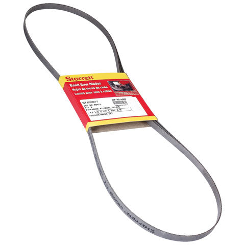

  • 44-7/8" (1140 mm) x 1/2" (13 mm) x 0.020" (0.5 mm)
  • Triple tempered M-42 cobalt high speed steel teeth with a fatigue resistant alloy steel backer
  • Patented "Twin Tooth" design of the Split-Chip advantage "bi-metal unique"
  • Faster cutting and longer life than ordinary blades
  • Starrett Univerz bandsaw blades available in a variety of tooth pitches
These 44-7/8" bandsaw blades utilize Starrett’s exclusive bi-metal unique saw technology for faster cutting and longer blade life.
Besides fitting LittleMachineShop.com portable band saws, these Starrett bandsaw blades fit Black & Decker, DeWalt, Greenlee, Makita, Unitec, Porter-Cable, Ridgid, Rockwell, Skil, Milwaukee portable band saws.
