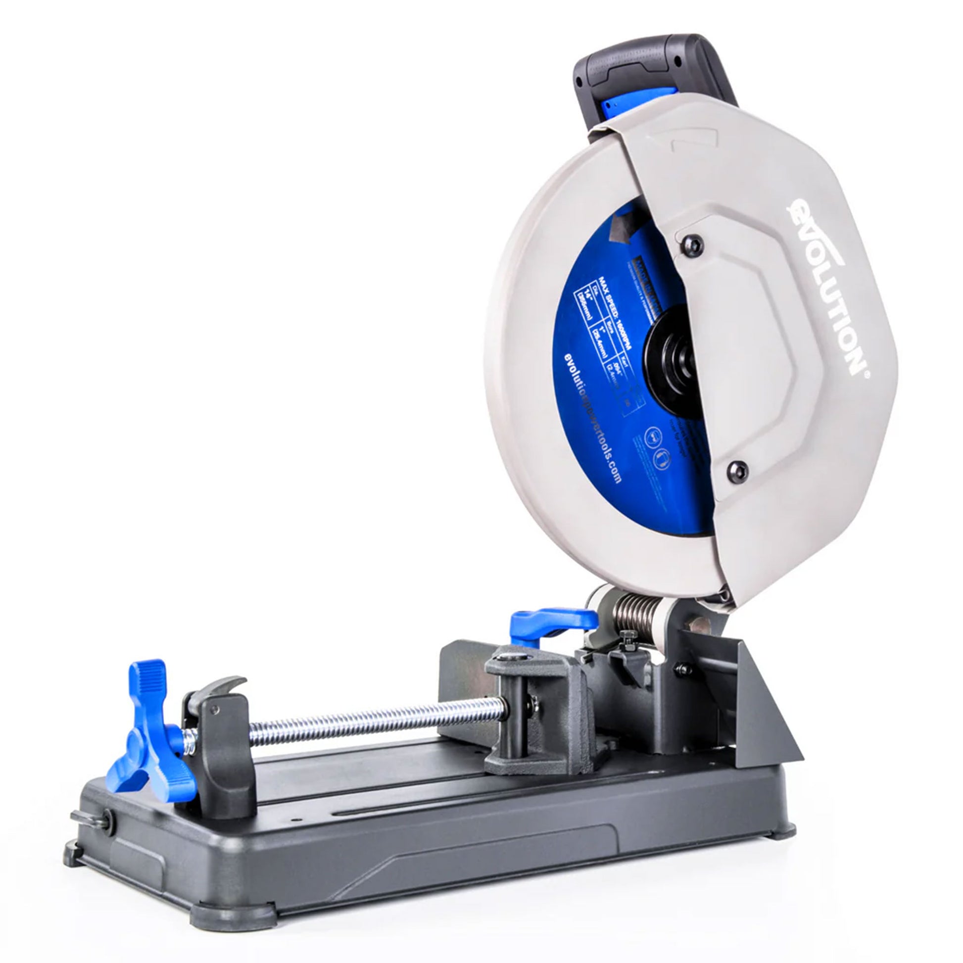

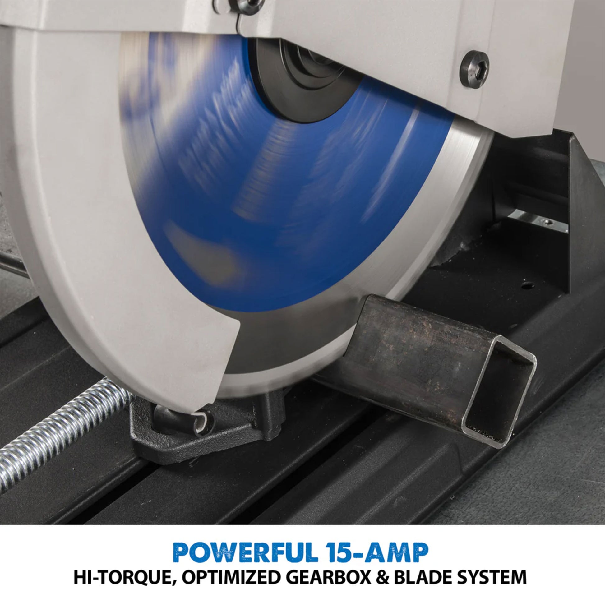

  • 14 Inch diameter blade with 15A (120V 60 Hz) Motor
  • Lightweight stamped steel base

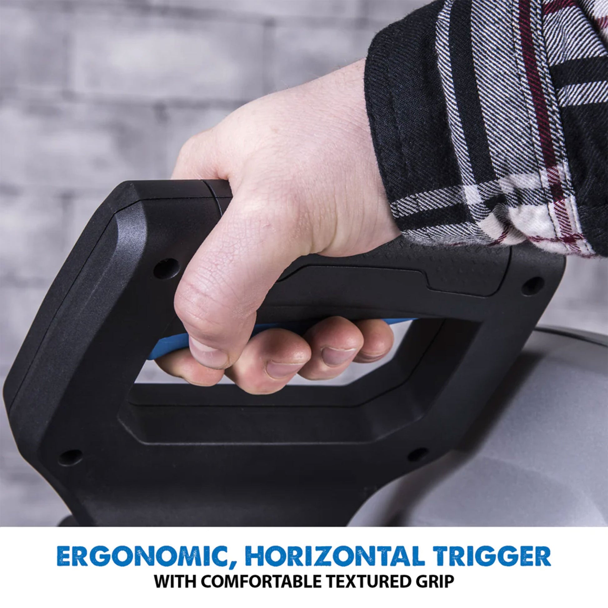

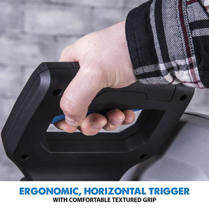

  • Ergonomic, ambidextrous trigger with textured grip

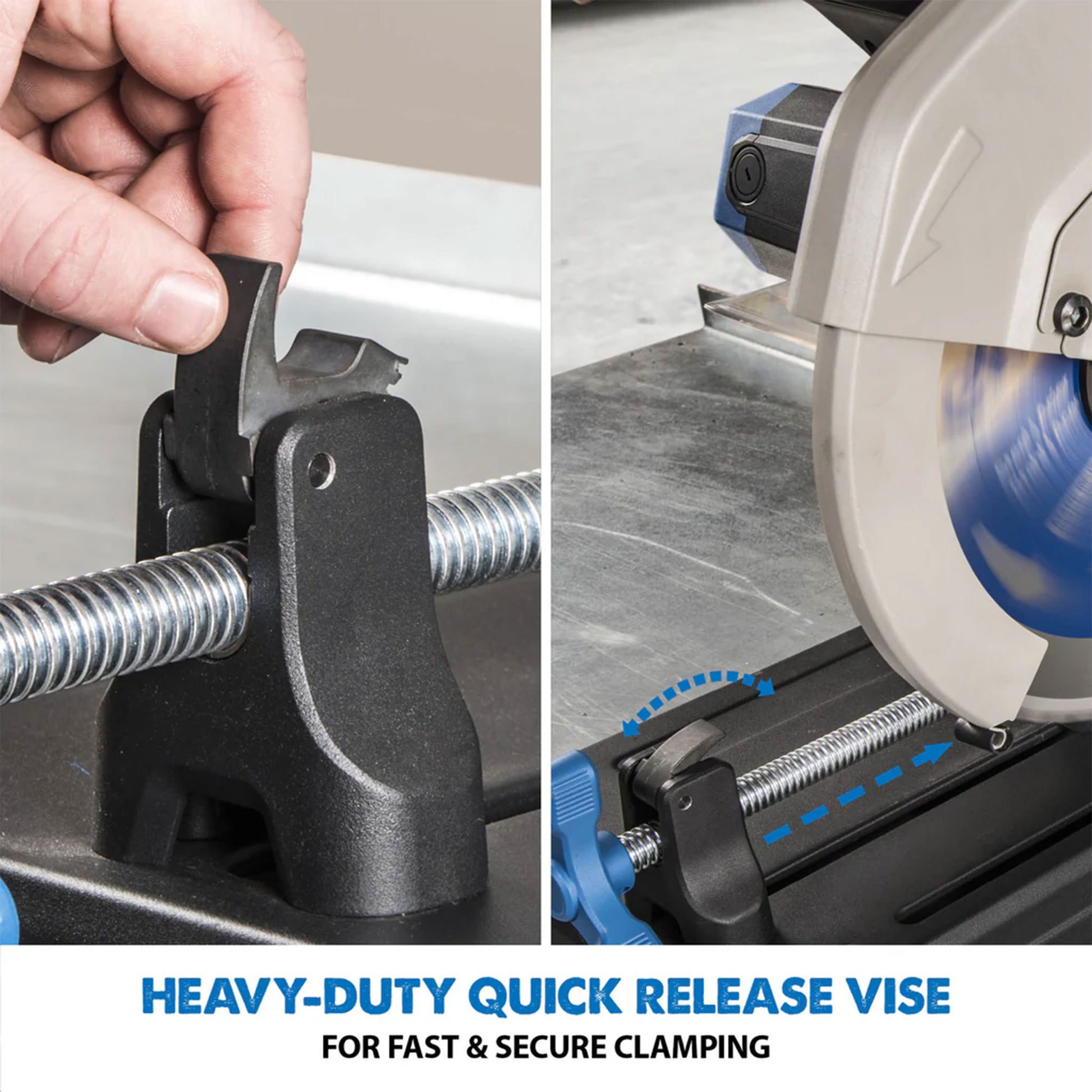

  • Accurate, durable cast steel vise with quick-release
  • Lock down pin & carry handle for easy transportation

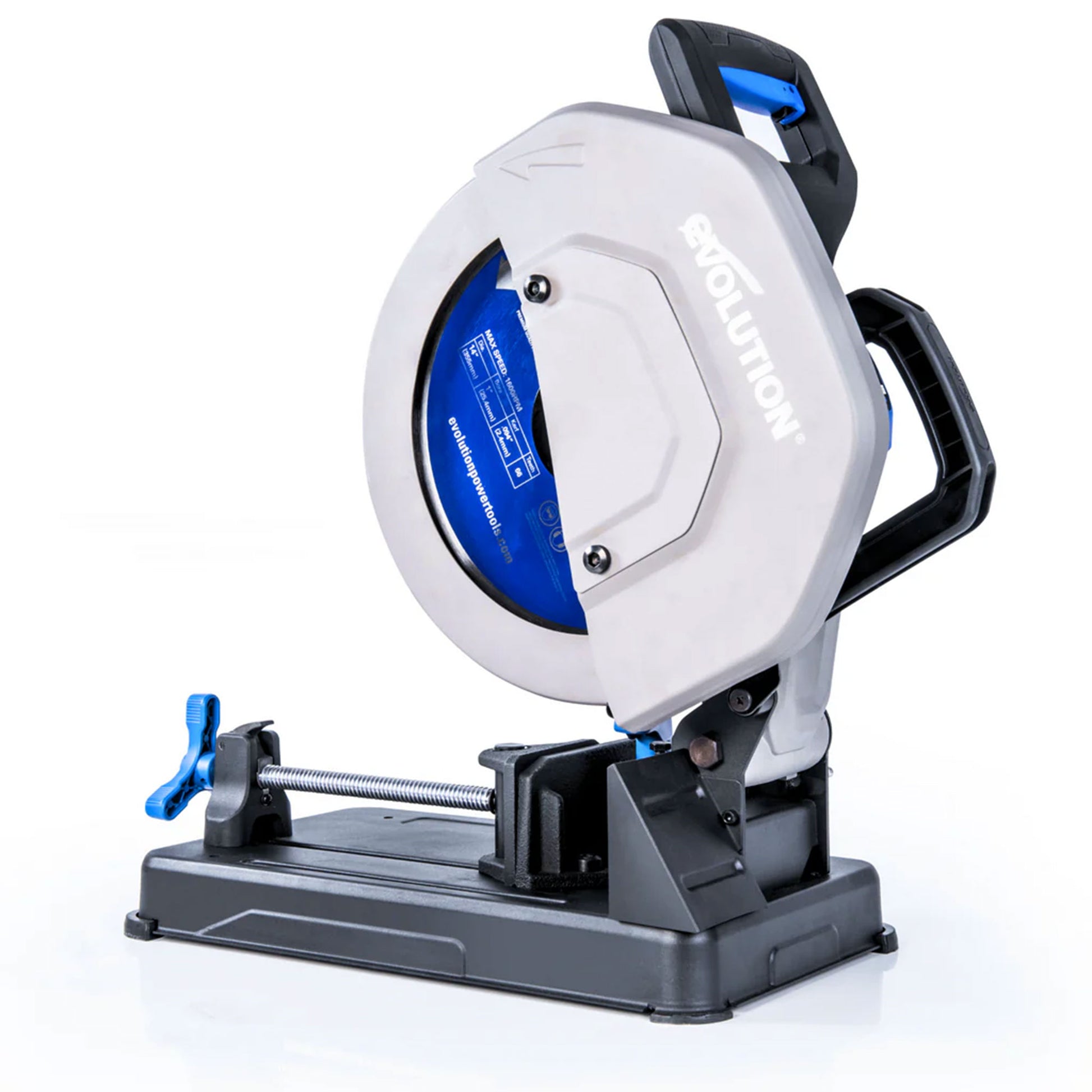

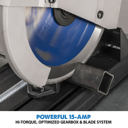

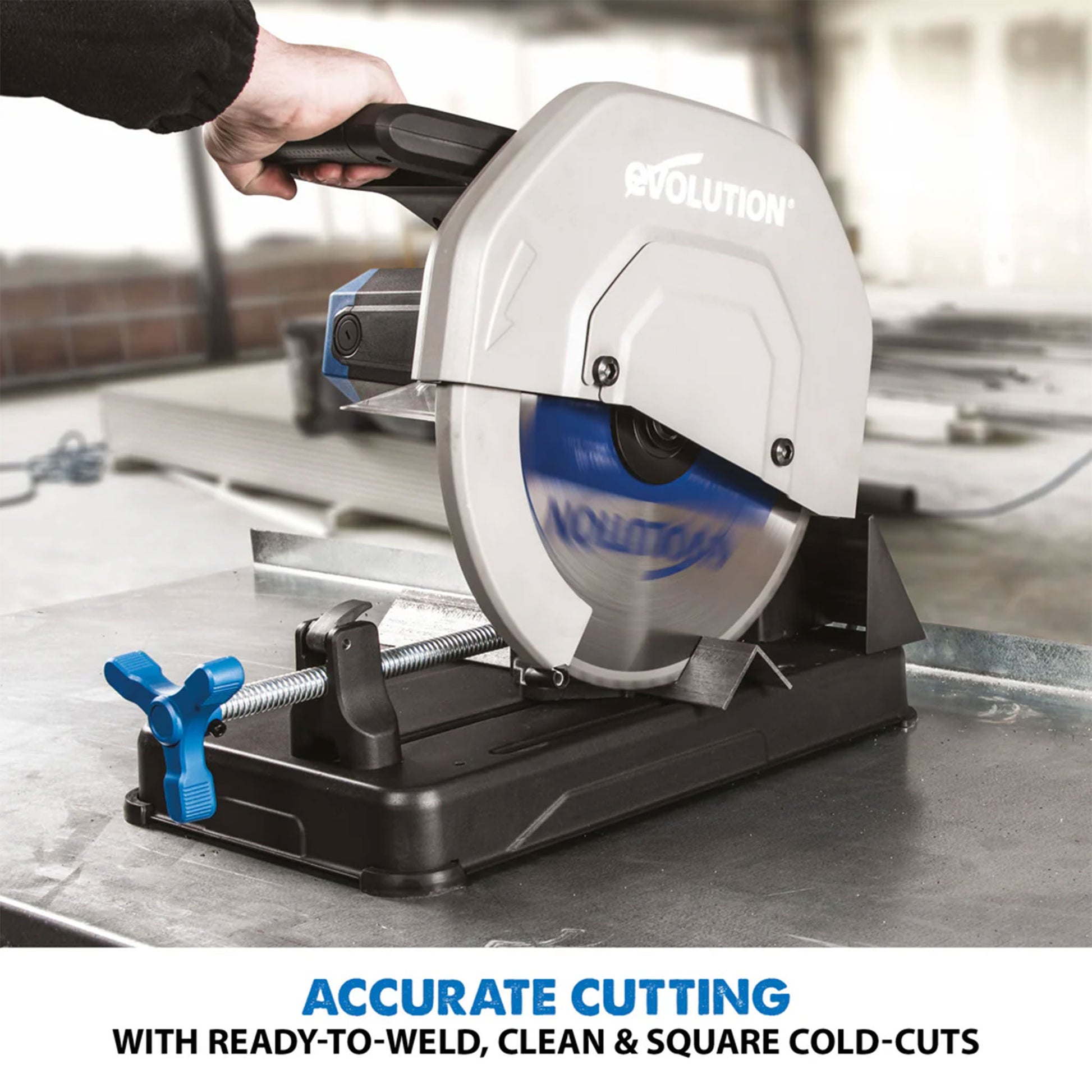

This 14" metal cutting chop saw is perfect for a small shop or as a portable work site saw. With a powerful 15A motor this saw can cut a variety of metals and woods.

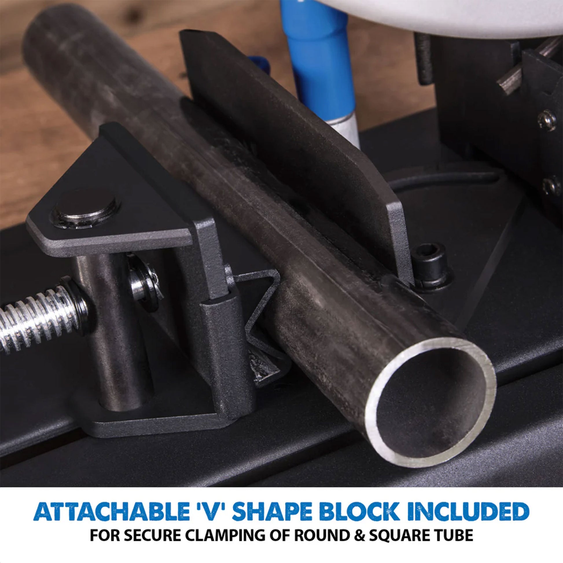

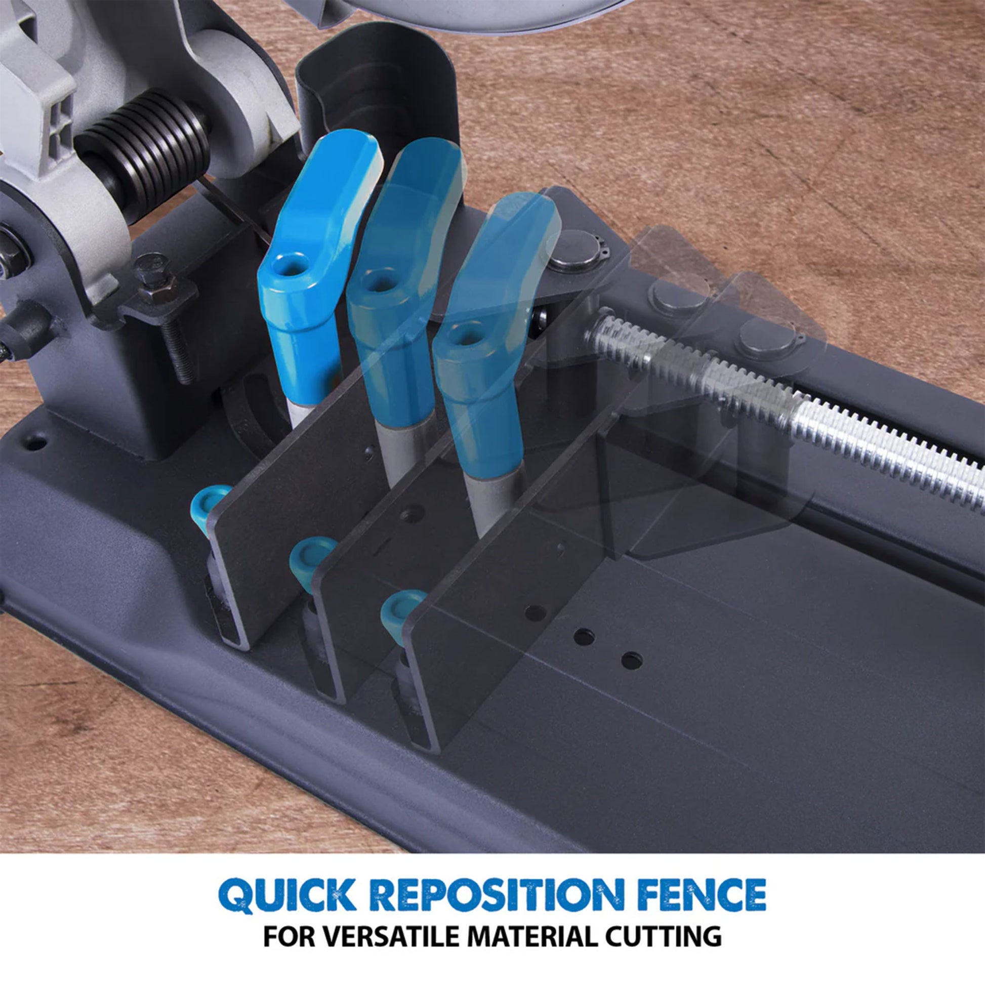

Cutting operations are aided by a quick-release vise with a robust threaded rod for fast and secure clamping. In addition, an accurate and durable cast steel vice with 0° - 45° miter capacity. An attachable "V" shaped block is included for secure clamping of round and square tube stock.

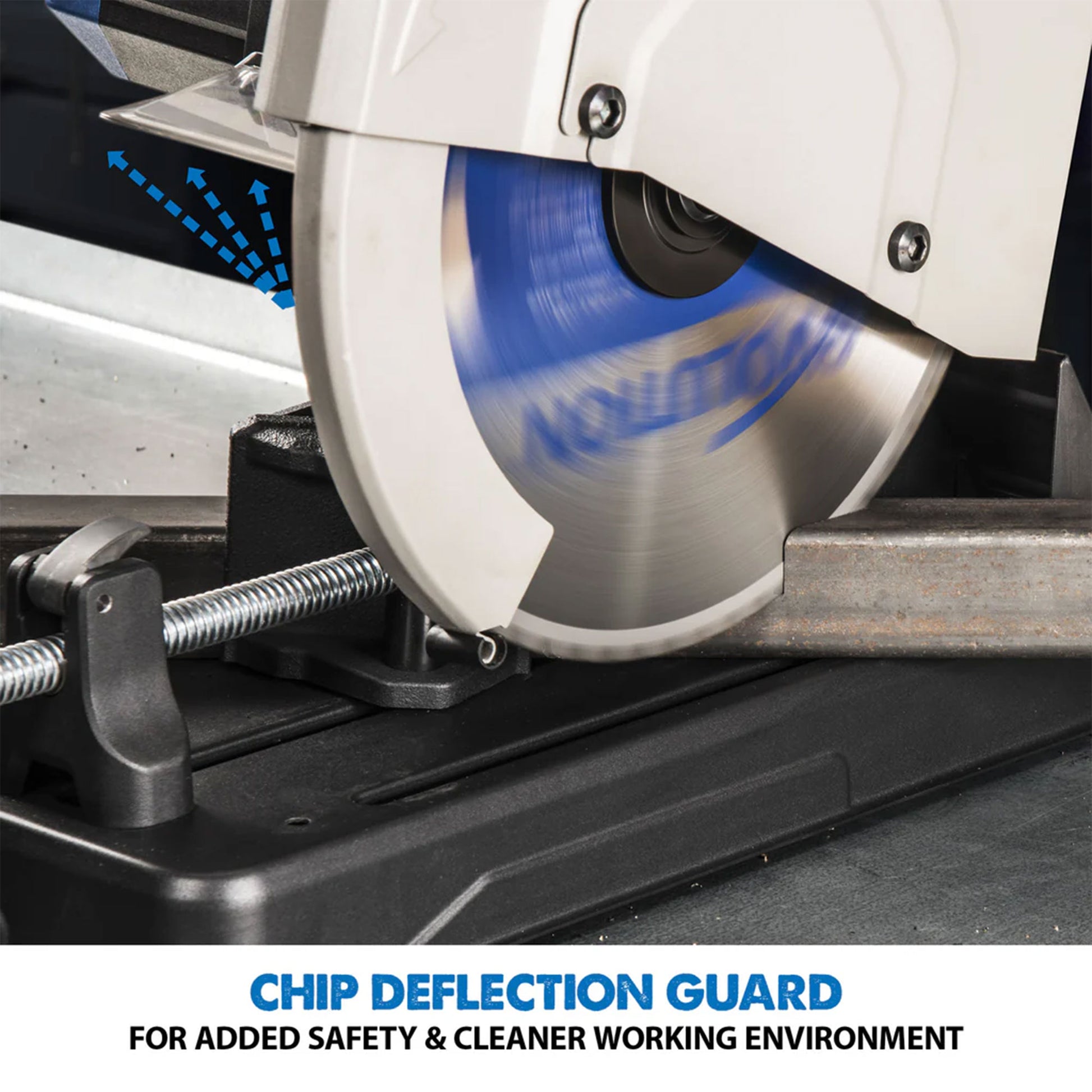

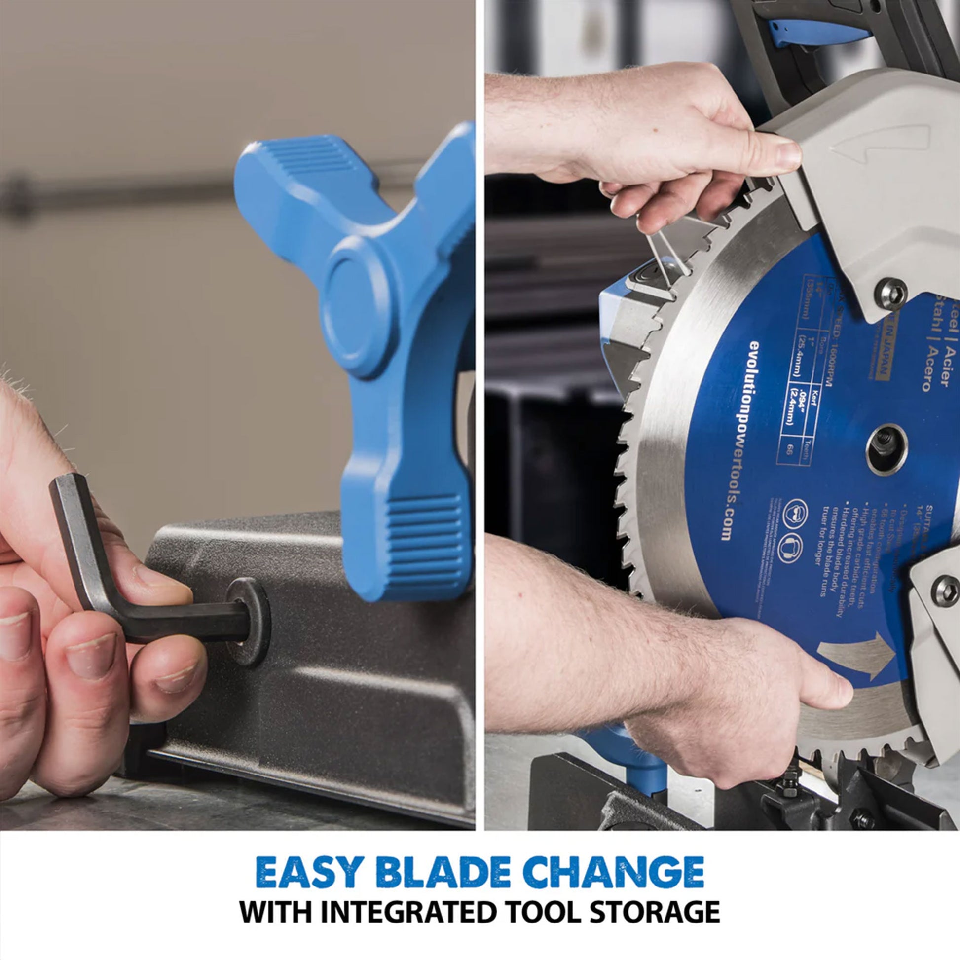

The saw is designed with an ergonomic, ambidextrous trigger that has a comfortable textured grip. A chip deflector directs chips away from the operator and also reduces cleaning time when finished. Also, the easy blade change design allows for quick transitions between different types of materials.
If you use the saw in a shop, the stamped steel base has integrated bench mounting holes, but it is also lightweight for portable use. In addition, the compact design with a head lock down pin and carrying handle allows for easy transportation.
The saw comes with a 66 tooth mild steel TCT Blade, Hex Key for blade changes and V-block for round and square stock.

Cutting Capacities
These are the manufacturers stated cutting capacities for the 14" metal cutting chop saw.
Mild Steel Plate (Max Thickness) 1/2 In.
Stainless Steel Plate (Max Thickness 13/64 In.
Square Tube at 90° (Mild Steel) 4-3/4 x 4-3/4 In.
Square Tube at 45° (Mild Steel) 3-1/2 x 3-1/2 In.
Rectangle Tube at 90° (Mild Steel) 3-3/4 x 7-1/8 In.
Rectangle Tube at 45° (Mild Steel) 3-1/8 x 4-3/8 In.
Round Tube at 90° (Mild Steel) 5-1/8 In.
Round Tube at 45° (Mild Steel) 4-1/8 In.
Minimum Cut Off Piece Length 5/16 In.
Motor: 120 V 60 HZ 15 Amps
Speed, No Load: 1450 RPM
Max. Bevel (Left): 45°
Blade Diameter: 14" (355.600 mm)
Blade Teeth: 66
Blade Bore: 1" (25.400 mm)
Blade Kerf: 0.094" (2.388 mm)
