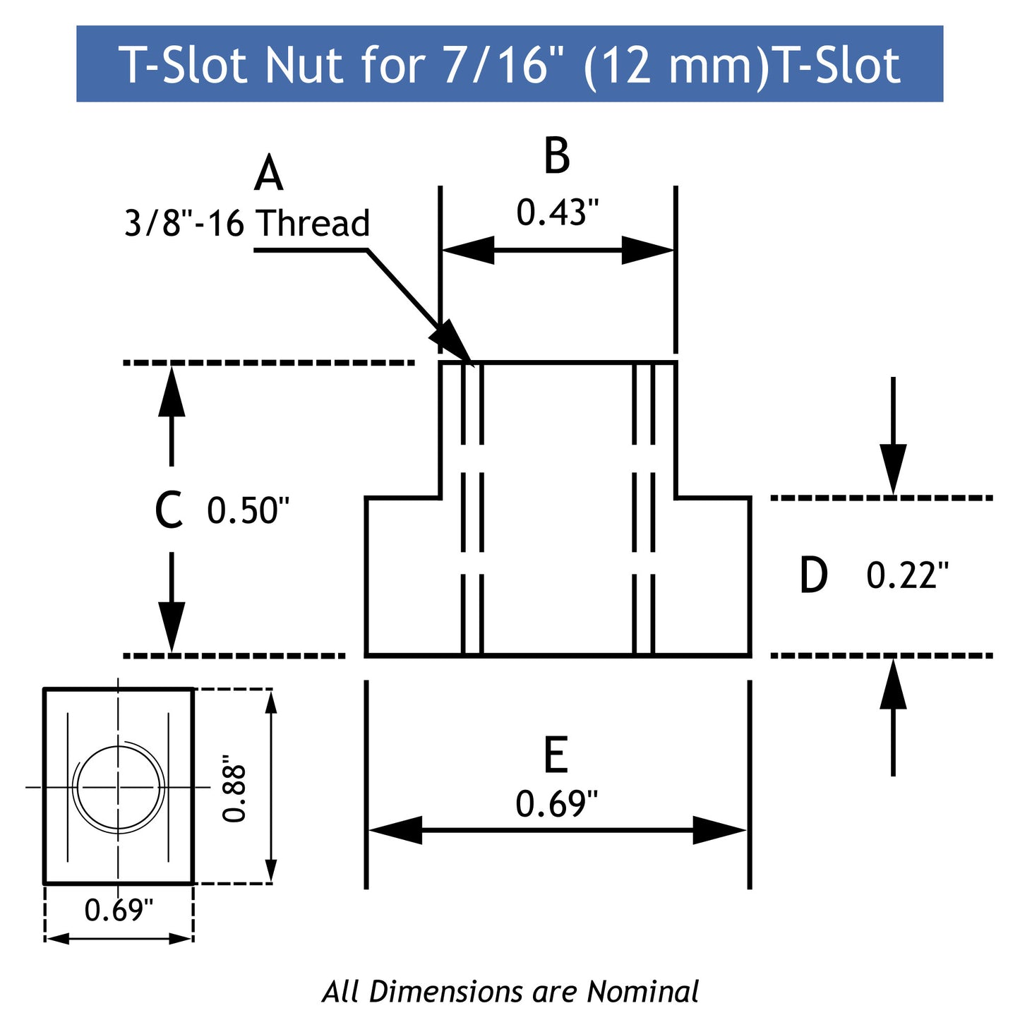

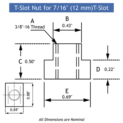

  • Nuts fit 7/16" (12 mm) T-Slots
  • Stud thread: 3/8"-16

T-Slot Width Range = 0.43" - 0.49" (10.9 mm - 12.6 mm)
*The stated dimension of the clamping kit is the width at the top of the T-slot.
Measure the width at the top of the T-slot on your mill table as shown in the photo below.
This is the dimension given for T-slot nuts and clamping kits. For example, if you measure 0.468 at the top of the T-slot, you should get a 7/16” (0.438”) T-slot nut or clamping kit.
T-slot measuring
Stud Thread: 3/8" -16
Nominal T-Slot Width: 7/16" (12 mm)
T-Slot Width Range: .43" - .495" (10.922 mm - 12.573 mm)
