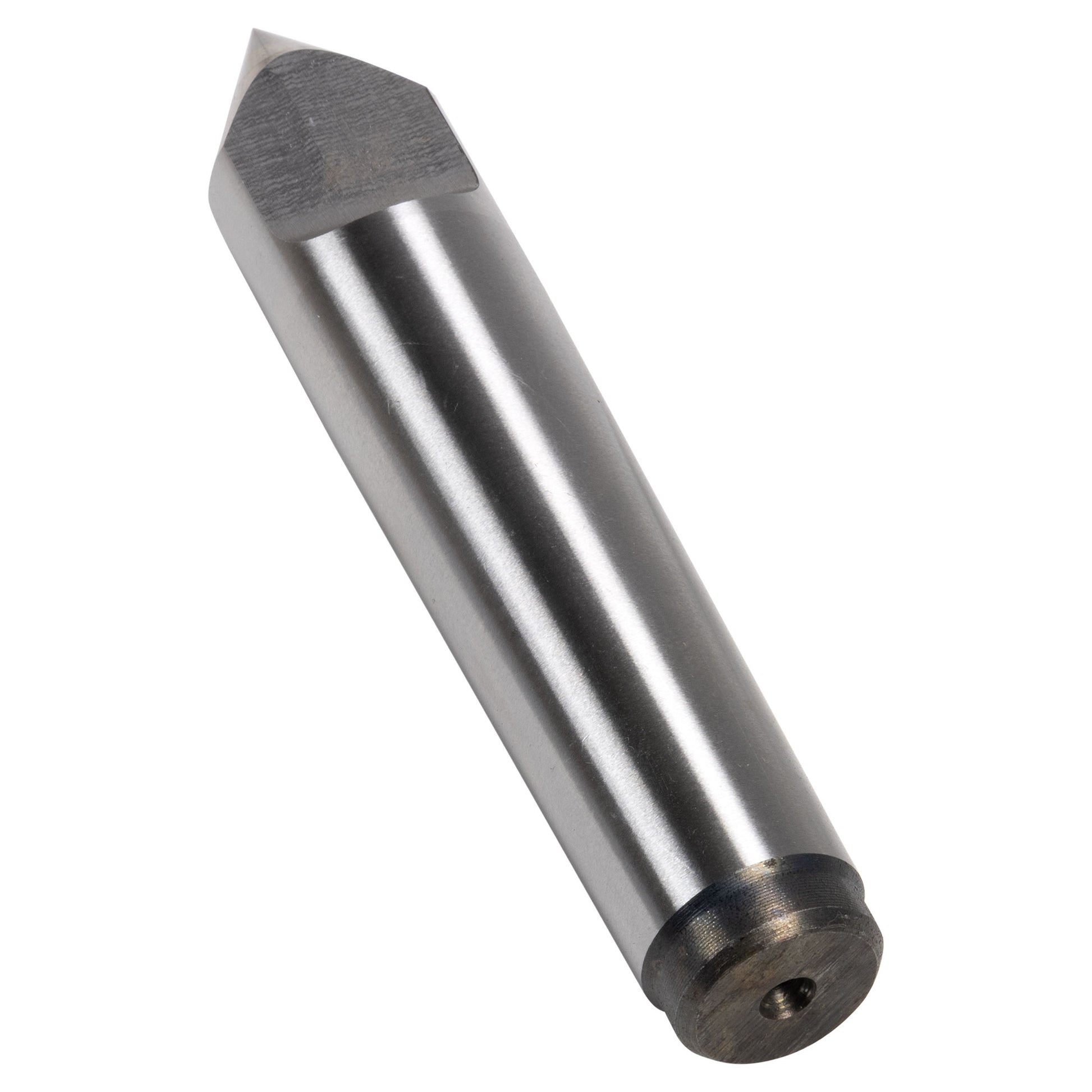

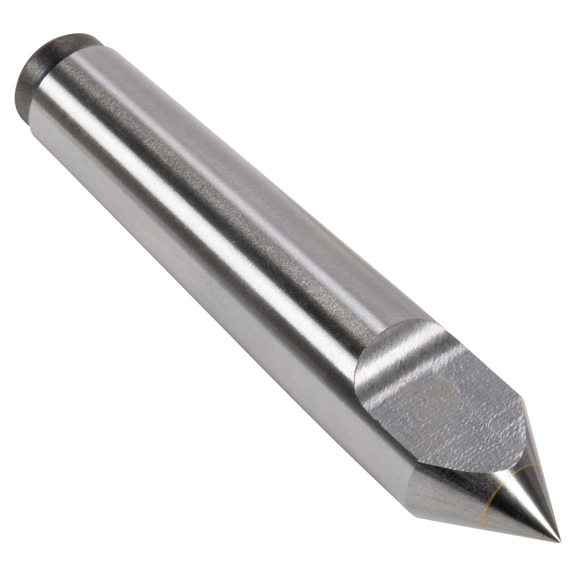

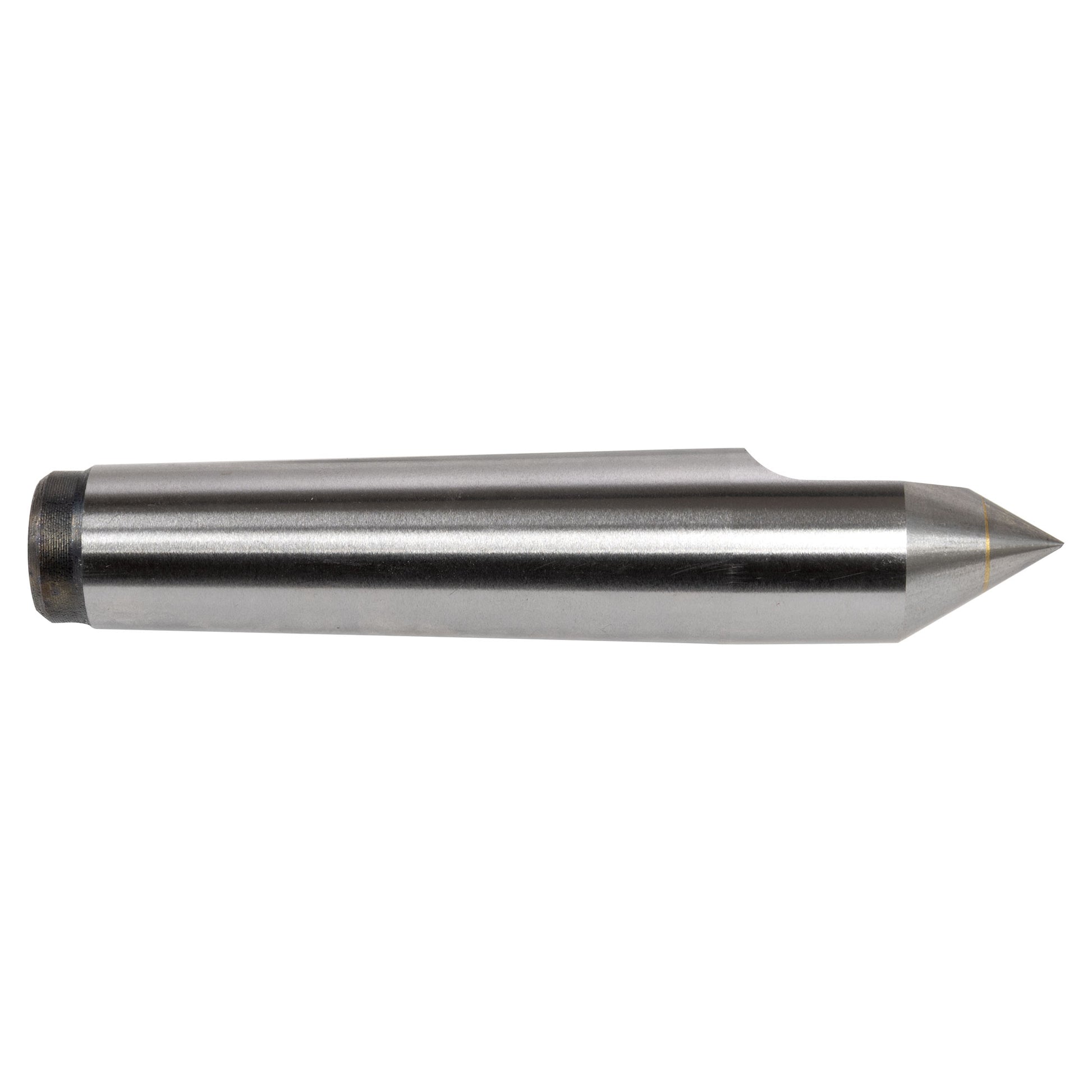

  • Made of tool steel, hardened and ground

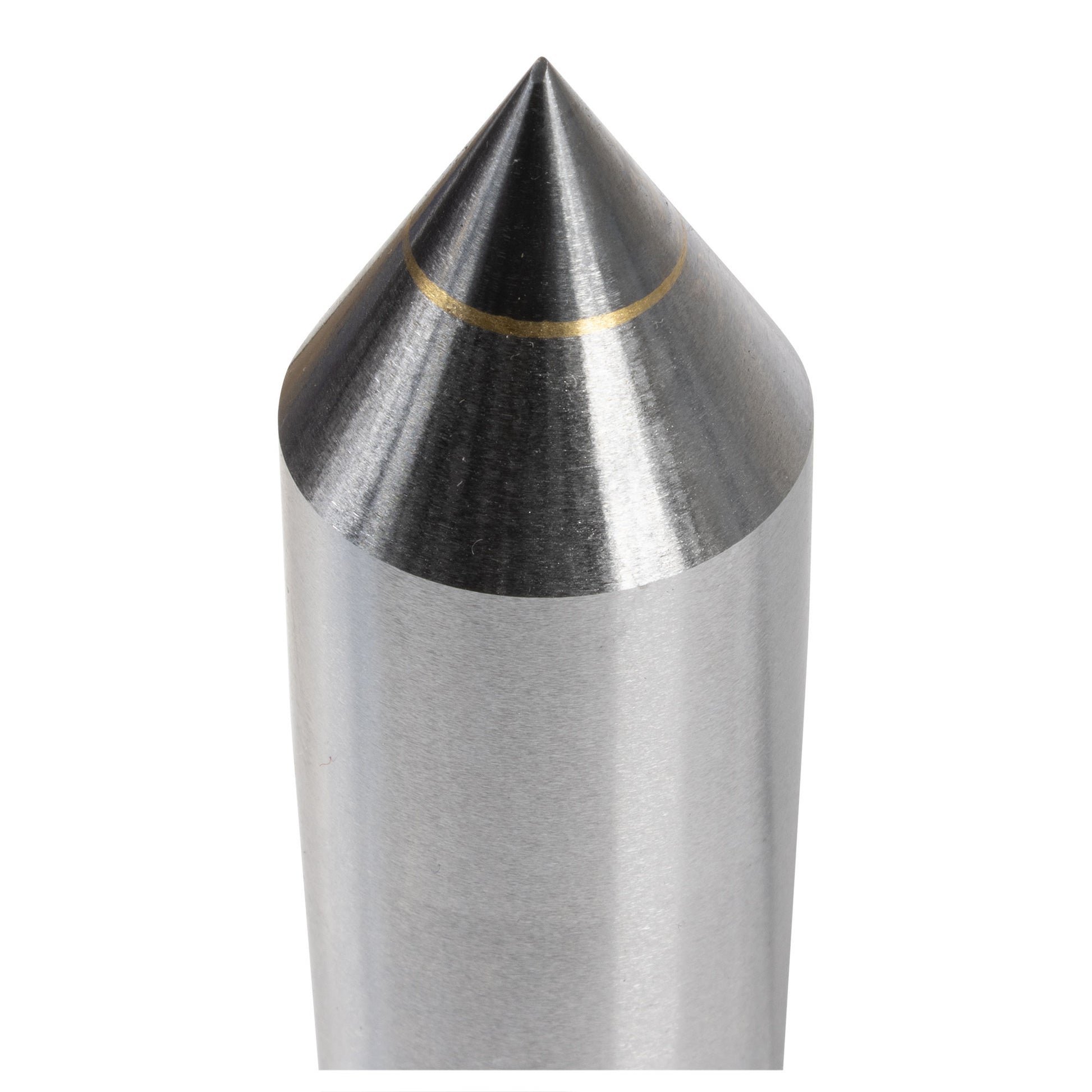

  • Carbide tipped, 60° point
  • +/- .0002" TIR
  • Diameter: 1MT 0.475" (12.065 mm), 2MT 0.475" (12.065 mm), 3MT 0.938" (23.825 mm)
  • OAL/Height: 1MT 3.15" (80 mm)/0.30" (7.62 mm), 2MT 3.15" (80 mm)/0.30" (7.62 mm), 3MT 4.92" (120 mm)/0.59" (14.99 mm)
This center is made from hardened steel and ground for accuracy. The point is a 60º included angle and half-notched.
The diameter of the 1MT dead center is 0.475". The overall length is 3.15".
The diameter of the 2MT dead center is 0.475". and the largest diameter of the tip is 0.315". The overall length is 3.15".
The diameter of the 3MT dead center is 0.938" and the largest diameter of the tip is 0.472". The overall length is 4.92".
TIR for these dead centers is +/- .0002".
Use this to turn between centers, using a live center in the tail stock, and a lathe dog to drive the part.
