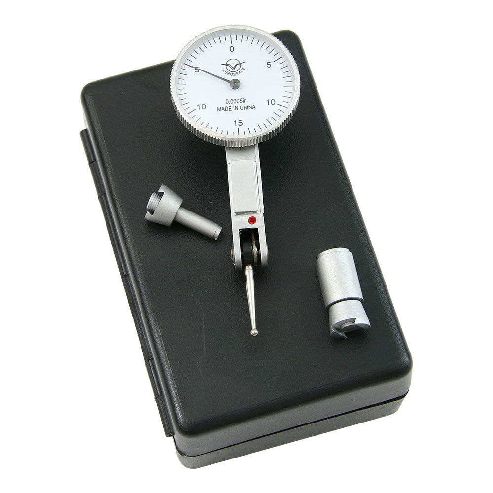

  • Dial test indicator with 0.0005" graduations
  • Range is 0 - 0.030" in either direction
  • Reading 0-15-0
  • Includes 5/32" and 3/8" diameter posts, dovetails on the back and end, and a 0.080" diameter point
  • 7 Jewel movement, Comes in a fitted case
Test dial indicator has 0.0005" graduations, a range of 0-0.030" in either direction, and reading 0-15-0. It includes 5/32" and 3/8" diameter posts, dovetails on the back and end, and a 0.080" diameter point. It comes in a fitted case.

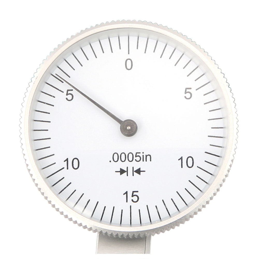

Chris's Tips
At rest, an indicator’s needle points at a random position, usually in the 10 o’clock range. This is completely normal, as the needle’s position at rest is irrelevant to the use of an indicator.
An indicator is only useful when the tip is bearing against a surface to be measured. The action of pressing the tip against the surface moves the needle, also to some random position. But this position is relevant; turn the bezel so that the needle is pointing at zero. Now you can make measurements, both positive and negative, relative to the starting position.
Range: 1" - 0.030" (25.400 mm - 0.762 mm)
Resolution: 0.0005" (0.013 mm)
Dial Reading: 0-15-0
