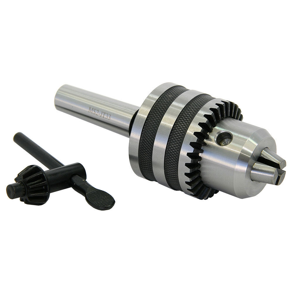

  • Package designed for mini lathe tailstock
  • Capacity 1/32" - 1/2" chuck
  • Hardened for high degree of accuracy
  • Key included
  • Drill chuck mounted on a short 2 Morse Taper shank for the mini lathe
1/32" - 1/2" Capacity drill chuck with hardened ground center jaw for improved durability and straight alignment. Mini lathe drill chuck runout is 0.008" (0.20 mm) or less.
2 Morse taper to 33 Jacobs taper. This arbor has a short Morse taper and does not need to be cut to use in the tailstock of the mini lathe.
This model of drill chucks for lathes also fits the Jet 1014 mini wood lathe.
Chris's Tips
Our 2MT SHORT Arbor is specifically designed for use on most mini lathe tailstocks. It gives you almost an inch of extra space between centers.
Don't buy this product for other small lathes that accept a standard arbor, as it won't eject from the tailstock when you retract the quill. You may need a standard-length drill chuck arbor.
