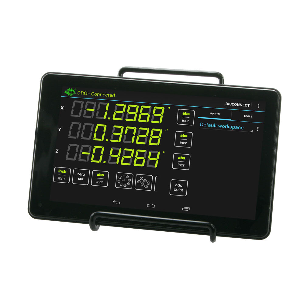

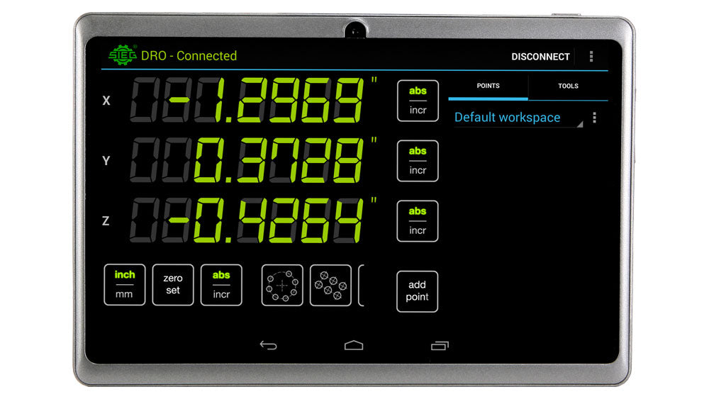

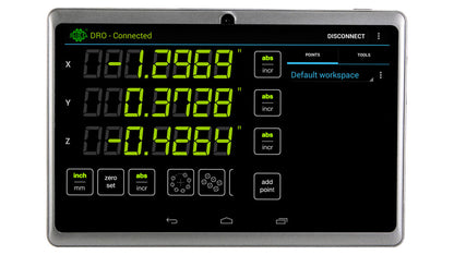

This Android DRO tablet makes a great readout for our Bluetooth DROs.
Bluetooth digital readout software is installed on this tablet, which comes with complete instructions. The software is a customized and fully-licensed version of TouchDRO.
